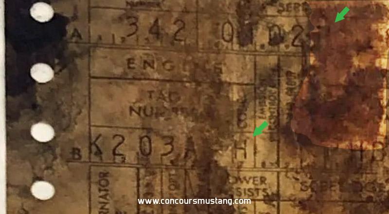

Re: Need engine tag number for a 351-2V Windsor 4 speed with out air
« Reply #11 on: November 17, 2023, 10:53:01 PM »
For comparaison to confirm the Windsor or cleveland engine you need to compare build sheet and Marti report.
I have 2 in my hands build sheet and deluxe report and all confirm the 351-2V Windsor is a engine code 8 on the build sheet
If any have theses build sheets for comparaison or for exchange contact me: Raytags@vif.com
Thanks!  Ray
Here is one that doesn't have an "8" in B7
Offline cobrajet_carl
  • Posts: 363
« Reply #12 on: November 18, 2023, 01:08:39 AM »
Hi!
Thanks!  Ray
Engine code "8" on a build sheet indicates a Cleveland on all of my build sheets that have an 8 instead of an H. The MPC, shop manual, Marti's Tag Book, build sheets, original metal tags etc. all show 200 series for 351W and 600 series for 351C. It is not even remotely debatable.
« Last Edit: November 18, 2023, 02:22:58 PM by cobrajet_carl »
Carl
70 and 71 Dearborn mach Is

Hi!  Everybody
Sorry is my error all 351 Windsor is a H code on the build sheet and in the serie 200 Engine tag Number
for 351-2V Cleveland is a 8 on the build sheet and in the serie 600 Engine tag number.
but for my research the engine tag number start with: K20?A
Need a copy of Build Sheet with a 351-2V Windsor with any manual transmission. Never find at this moment.
Thanks! for your help  Ray
