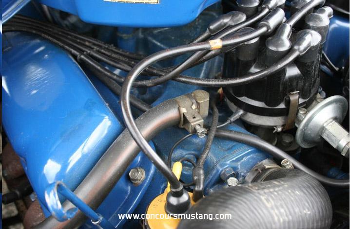

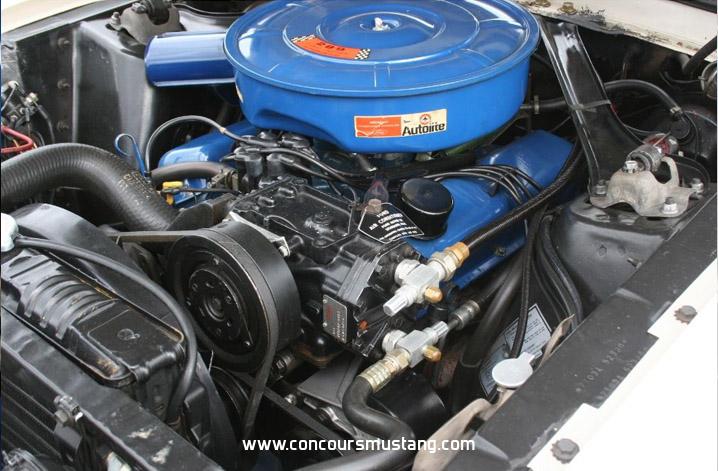

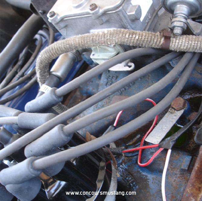

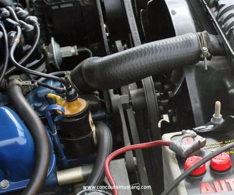

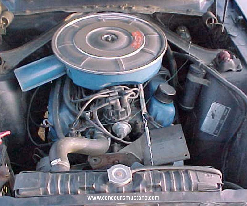

As promised a few pictures. Since you didn't respond back yet didn't focus on a production period.
Since the thread I posted a link to focused on the air cleaner figured we didn't need a bunch of them. For you and or others does show the typical location and orientation of the service sticker on the drivers side shock tower found a many of the examples from that plant and year but you would need to double check when your car was built and compare it to be certain. Wrong distributor advance unit and an odd after market AC unit was installed at some point in the past.
As for other details here are more. Take note of the notes since many of the pictures include things that have been changed so want to call out some of those so you don't get mislead
Some other C codes
Rear of intake area. Note the brass and vacuum lines and connections were not painted
Front intake area. Ignore the choke air tub and covering someone tossed on top of the intake  ::) Note that engine ID tag and retaining bolt were not painted with the engine
From a very nice unrestored A code which would share all the same painting details as a C code. Happens to be a NJ car also
Hope these help
