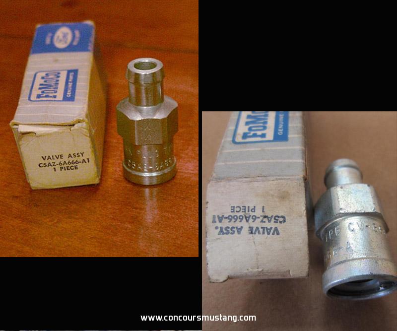

Some examples from -A1 version

If you look at the pictures that Jeff posted and what I was referring to, the valve on the right is what I would identify as "dull zinc/cad" plating. (Cad got banned for Military use sometime in the 70-80s time period.) The one on the left I would call "clear zinc" plating. "Clear zinc" is the term used in Silicon Valley to identify in simple language what you wanted to the plating shop to do, the shiny stuff. They understood it was to a Mil-Spec. The terminology was part of our "KISS" approach - "Keep It Simple Stupid". That approach got us to the moon and back.
Since you did not specifically identify that you were referring to one in Jeff's picture I missed the association. Maybe next time please be more clear for people like me that need more clarification. Regardless not too dull IMO. Bright zinc is in layman's terms and more descriptive. I try not to talk over anyone's head If I can help it because I know people here appreciate easy to understand context. Clear zinc although a correct term can be confusing to those who are not versed in the different plating finishes.  I have had dozens and dozen NOS C5,C6 and C7AE PCV valves that were "bright zinc" (Jim uses clear zinc) to begin with and then over time and exposure to different atmospheric conditions dulled down. I have had NOS cases of the PCV and had to inspect each box in the case because some may be bright zinc and others were dramatically different in appearance because of light corrosion. Consequently pointing this out because I don't believe they started out dull as you seem to infer.
