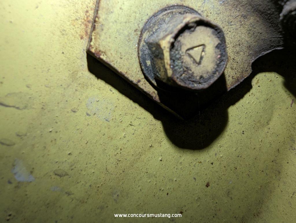

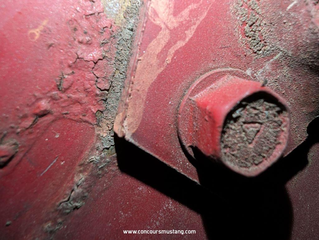

Morning everyone.  My question is concerning the correct bolts for door hinges on a 1970 Mercury Cougar Eliminator, Dearborn built on 10/2/69.
I have TWO 70 Eliminators and one 70 convertible, all built at Dearborn and they all have the bolts seen above with the little triangle in the middle.  I've got one bolt that broke and I need to replace it.  All the reproductions I've seen have a dimple in the middle and not the triangle, as seen below...
I found some in my parts stash that came off of a 70 XR7 hardtop, that probably wasn't a Dearborn car...
Does anyone know if all Dearborn cars used the bolts with the triangle in the middle or if they are even reproduced?

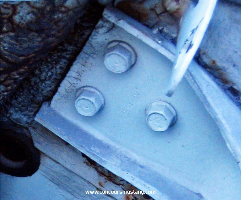

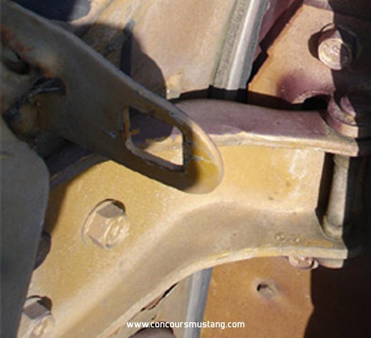

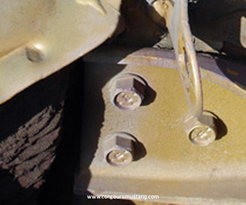

Here are some examples I found
0F17219x
And 0F5691xx

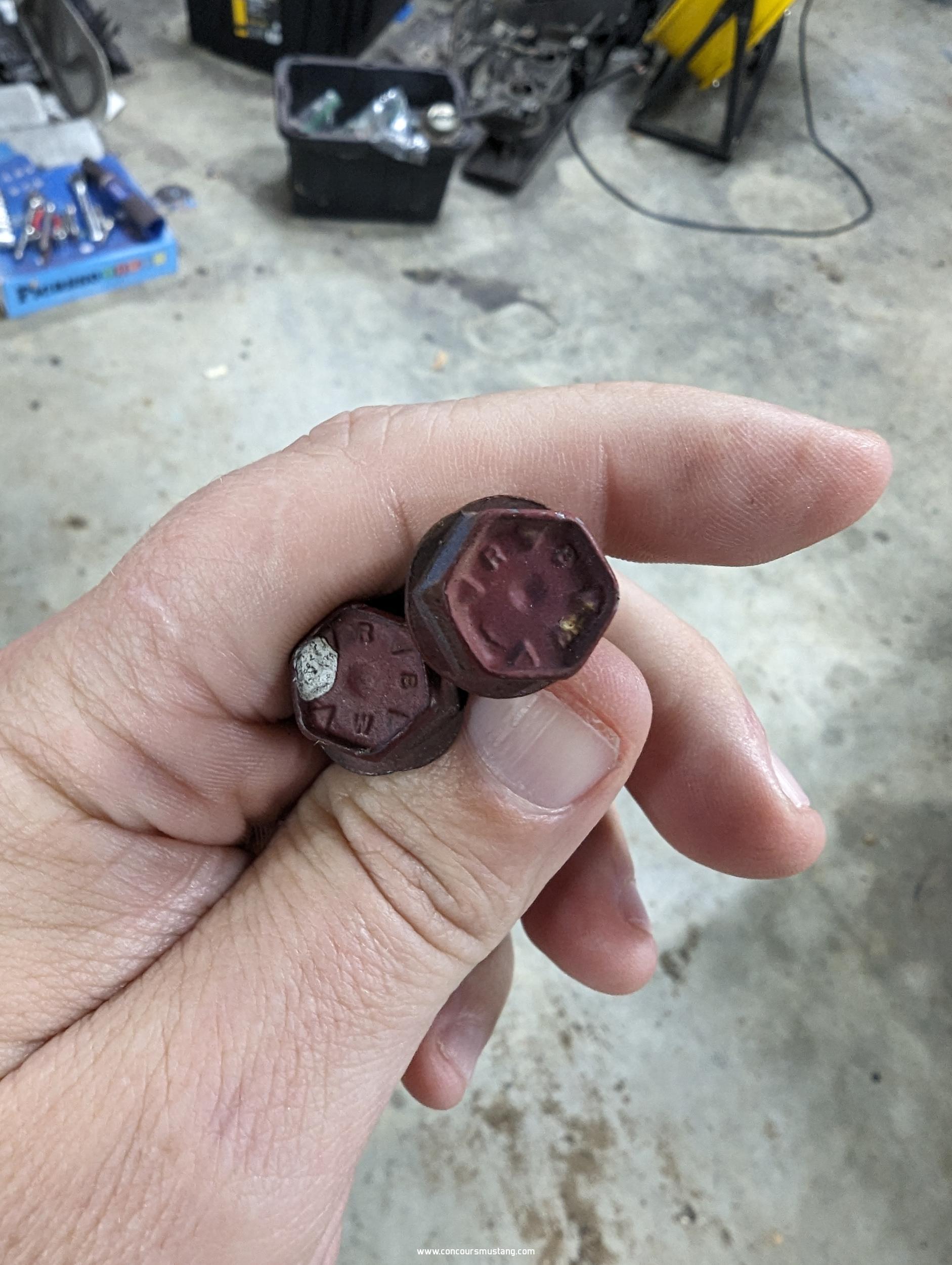

  • Posts: 1123
Re: 1970 correct Dearborn door hinge bolts
« Reply #8 on: February 29, 2024, 11:13:11 AM »
The bolt head markings were vendor ID.  R B W.   Rockford Bolt Washer. if i remember correctly.
