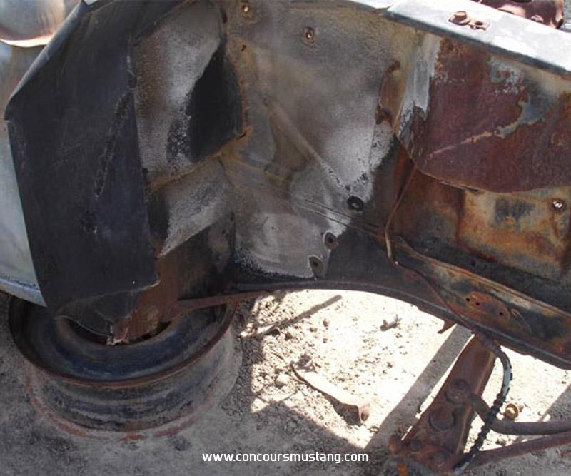

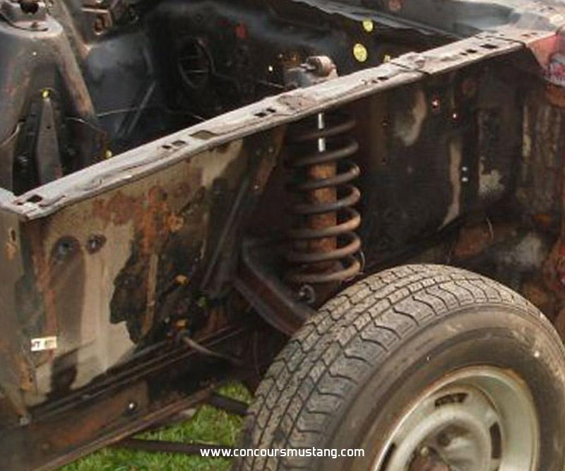

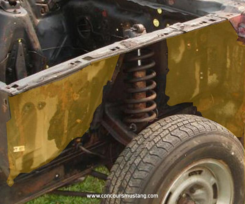

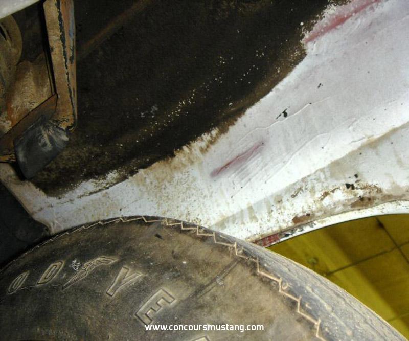

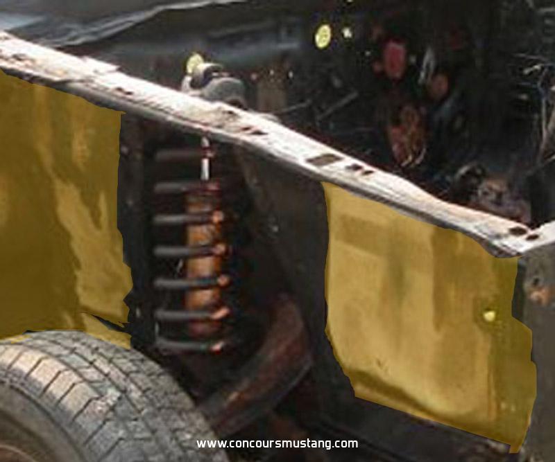

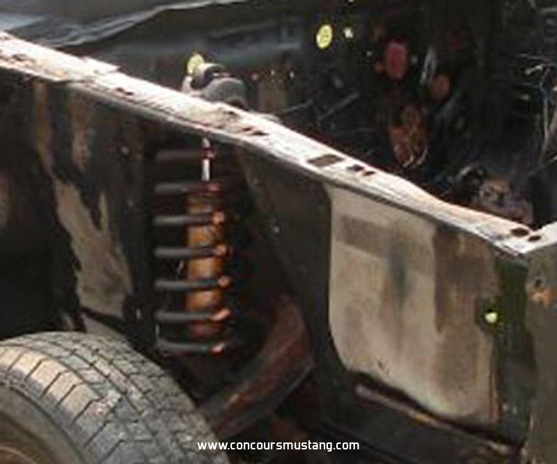

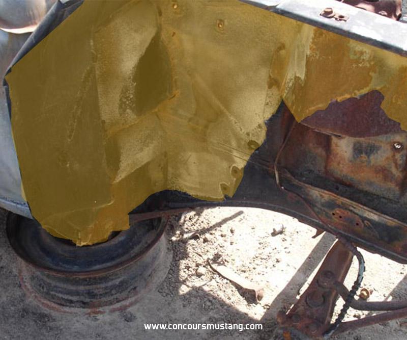

Note:In most if not all of the pictures the front and rear splash shield are not on the examples so we see pretty sharp edges at the front of the wheel well and at the rear we see the edge of the cowl but not the shield. In both areas the sound deadener pattern continued to on the splash shield with the goal to cover the shield and add some sealant to the joint where the shield and the inside of the fenders met. This was not always completed mostly at the front outer edge to fender joint.
Sound deadener was applied directly over the inner fender panels that were painted semi-gloss black earlier in the process and after the car was pretty much complete with the front wheels yet install or in place it appears. Or at least that makes the application process for us much easier
Drivers side
Bottom of the fender often got a pass of the application wand as shown in the example below
