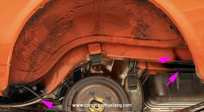

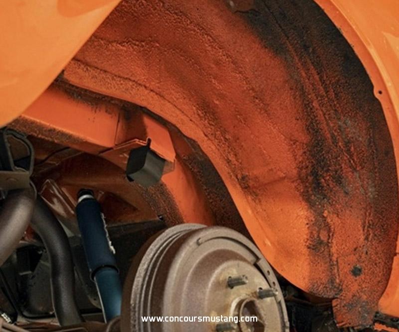

Re: Underside color of September 65 and wheel wells
« Reply #2 on: February 12, 2024, 02:43:38 PM »
Don't forget the black pinch weld black out that would extend slightly at the forward area and the section at the rear onto the lower wheel well edge or frame when the spray started up again at the back edge.
Just one of hundreds of examples
One example of the black overspray
Close ups
