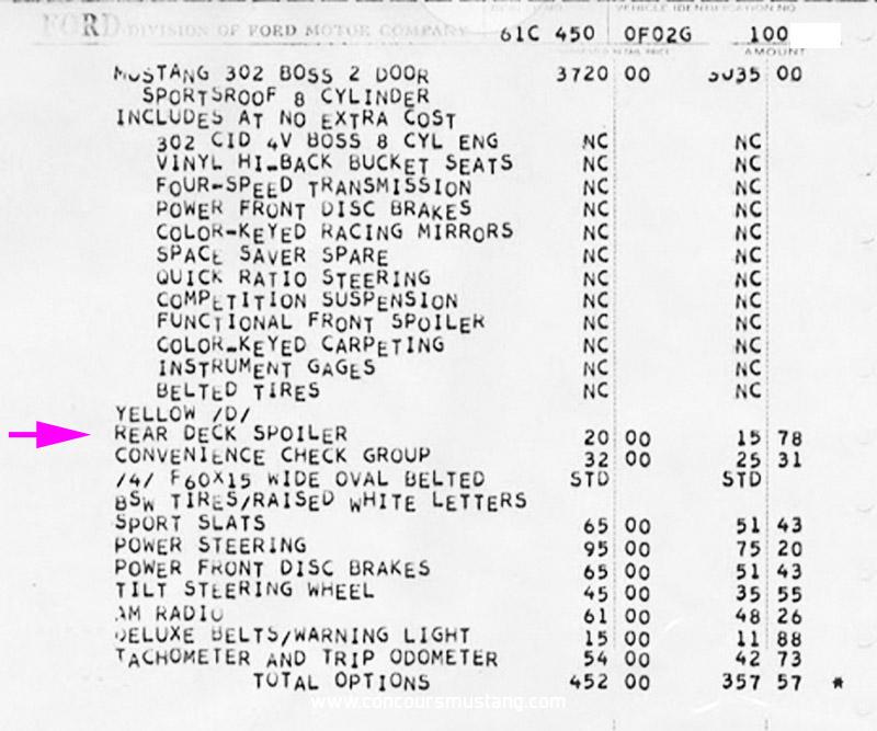

Here is my report
Re: front and rear spoiler question. Was it dealer installed?

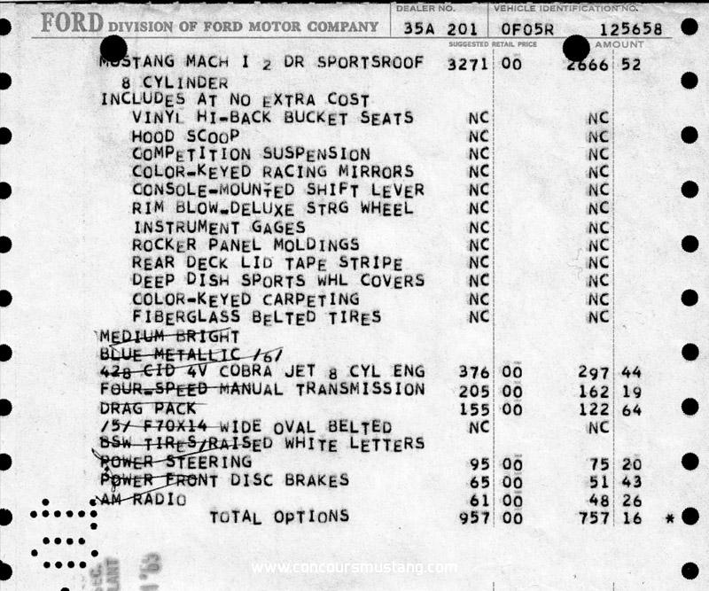

« Reply #7 on: March 02, 2024, 04:00:39 PM »
Not a Marti report but the second copy of the shipping invoice. Reposted to make it easier to view
As we can see there is no rear spoiler listed
Here is another invoice for a car where the spoiler option was ordered, installed and listed in the shipping invoice for comparison
Do have other examples with the spoiler option
