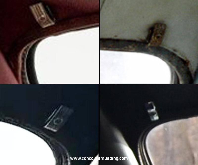

Not many pictures as its not typical that people take pictures of that specific part on their car
Top left - top right - bottom left and bottom right 7T122xxx-7T155xxx-7T207xxx-7T293xxx

Thanks for the pictures Jeff. To me, the bottom right picture 7T293xxx, looks like the coat hooks I removed from our 67 coupe. I know the picture isn?t very clear, but if you zoom in, that coat hook looks like it has a different shape than the other 3 pictures.

Would agree that the picture might be but sorry it wasn't any clearer. So we may have two examples just need to find more to support the possibility especially from what appears to be late build NJ examples
