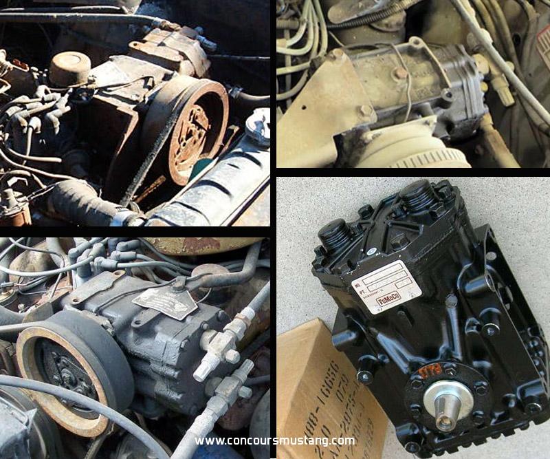

Whats the easiest way to tell them apart visually? I know the material difference between the two but ifnim looking at pictures how can tell?
Thank you all!

Besides the weight difference the castings are different .  The York is thinner and the beefier one is the cast iron Tecumseh. Get pictures and put them side by side and study them would be my suggestion.
Re: AC Compressor PN?s
« Reply #8 on: March 13, 2024, 01:29:59 PM »
Another way is that the York is cast aluminum while the other is cast iron
York on right. Notice the depression in the casting on the top (once installed) side of the main body
