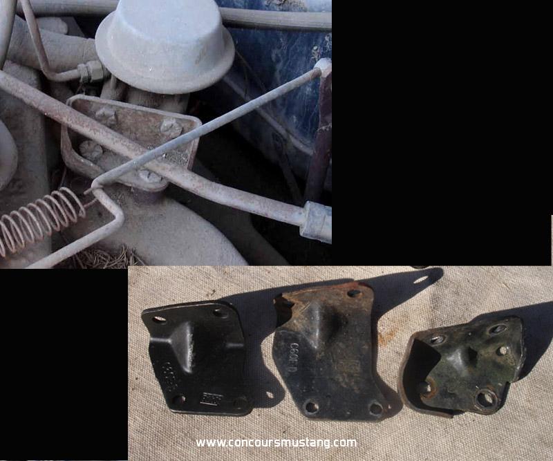

Looking for help in identifying the application(s) for the pictured thermactor system 9B290 anti-backfire (gulp) valve bracket.  TIA

Turns out that this is a 1967 390-4V/410/428 bracket.  A friend gave this to me, and he normally deals in Galaxies and Thunderbirds, so is likely a 428 part, which would make it the C6AE-9B290-C.  The Mustang 1967 390-4V would have used C6OE-9B290-C.  What about the GT500 428 PI engine - which of these would that have used?  The 428 PI drawing shows C6AE-9B290-C, but that is geared towards a police car not a Shelby.

Turns out that this is a 1967 390-4V/410/428 bracket.  A friend gave this to me, and he normally deals in Galaxies and Thunderbirds, so is likely a 428 part, which would make it the C6AE-2B290-C.  The Mustang 1967 390-4V would have used C6OE-2B290-C.
A couple of pictures to add to the discussion

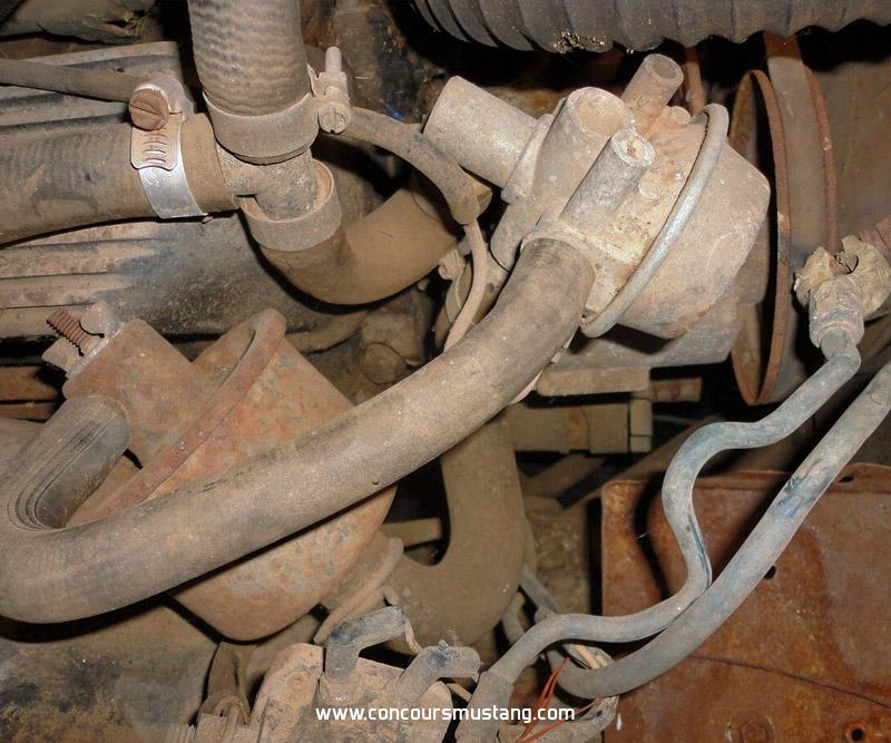

Given the different intake and multiple carbs the valve was not attached like the 390 Mustangs/Cougars
Hoses were shortened and the valve was mounted right above and behind the pump and was held in place by just the rubber hoses attached to valve. Yes there is an incorrect non original hose clamp in picture

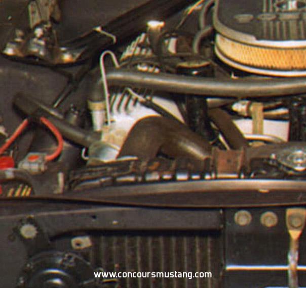

Here is another picture from 67 with the bracket not attached to the valve. Thee 390 Mustang valve was not used for the GT500 application. The GT500 used the same three port valve as the 289 where the 390 used the two port. Wasn't like they installed the whole 390 Thermactor assembly and left it at that. Number of other parts are different between the two systems also.
