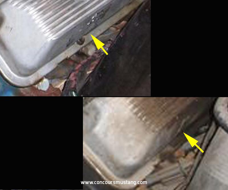

See plenty of them on restored cars but here are a couple of examples on unrestored 70 428CJ Mustangs. Not much left but believe both are the remains of the original timing/emission stickers. Hope this helps
Re: 70 428CJ Question about emissions sticker
« Reply #4 on: April 11, 2024, 09:36:22 PM »
Jeff's photos show original stickers. Restored vehicles rarely get the details right.

the decal is D0OE-9C485-J
I helped ECS make them some years back, they still sell them.
when installed in the factory position, it was typical on the originals to have an elliptical piece of the decal get punched out on the bottom area when someone used a socket to tighten the valve cover bolt below it.

Tucson Bruce, are you the Bruce of 428CJ Convertible fame?  (Don't want to post any names without an OK ....) If so, I think I loaned you a valve cover way back to have that decal made. (In return, you found me the REALLY hard to find fan clutch for my 70 CJ, thanks' again) I'm sure I still have that Valve cover somewhere, I'll dig it out and posts some pic's. It came off a really original low mileage wrecked car in the early 1980's. I have pics of 4 or 5 original decals on cars, every one is missing the piece over the valve cover boss ....   John

« Reply #13 on: May 06, 2024, 01:51:39 AM »
