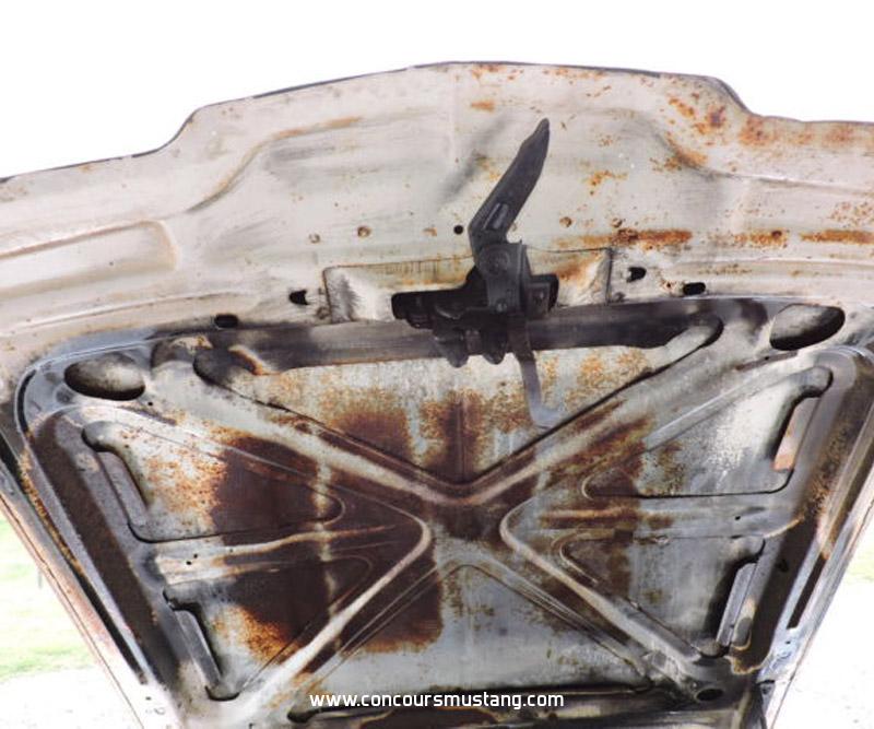

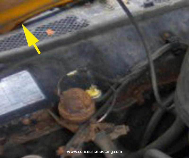

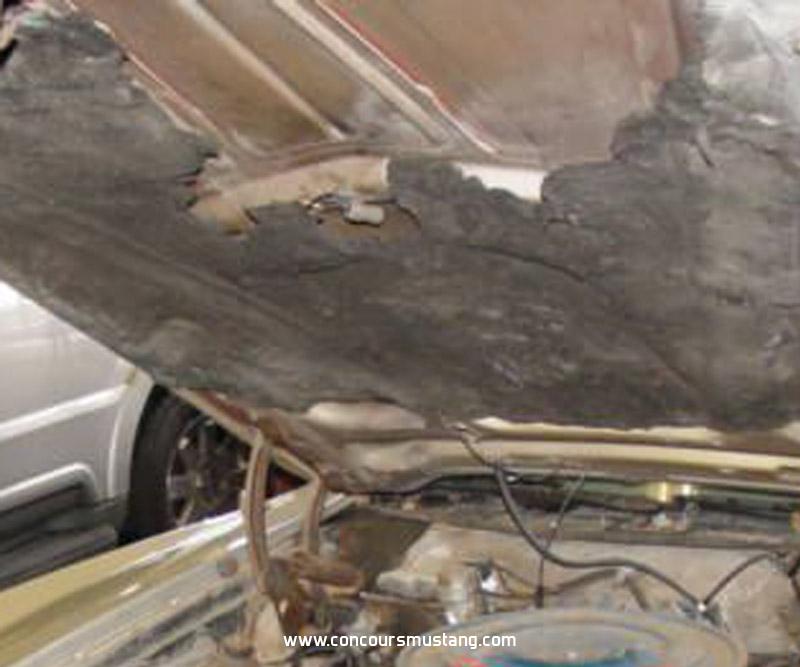

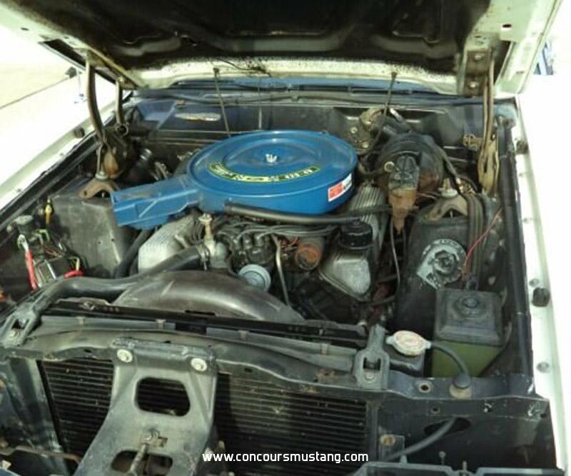

Not sure if your mixing in the Spoilers or not
Would be the same as Torino and Ranchero built cars. Same car plants and same production lines inside the plants
Some would have come equipped (like some Mach Is ) with the black insulation pads attached to the underside of the hood
Unrestored cars
69 Cyclones

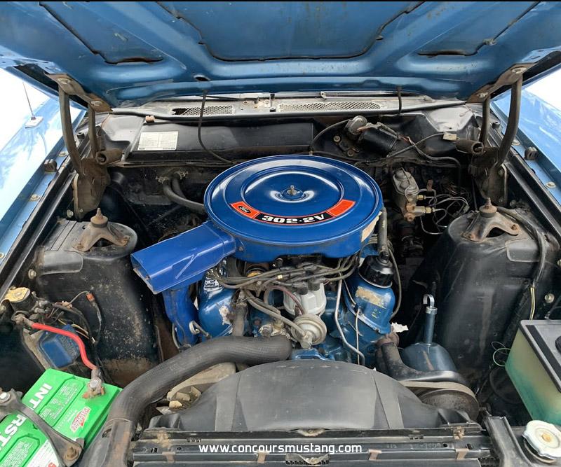

Spoiler

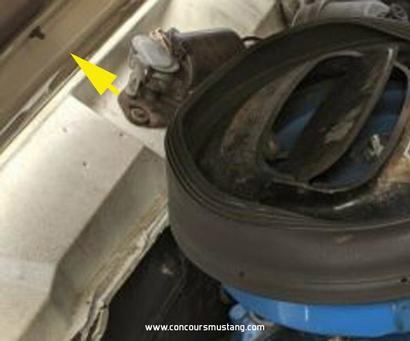

70
Body color (Torino)
Cyclone

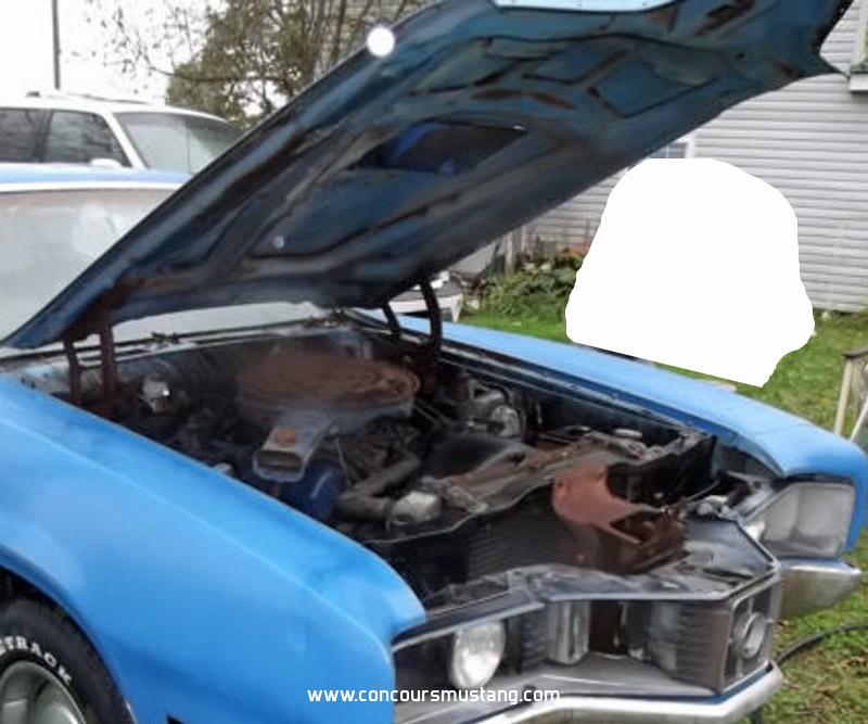

71's (Torinos)
Body color
With a black center - may be undercoating applied a prior owner. Have seen this before

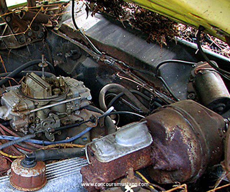

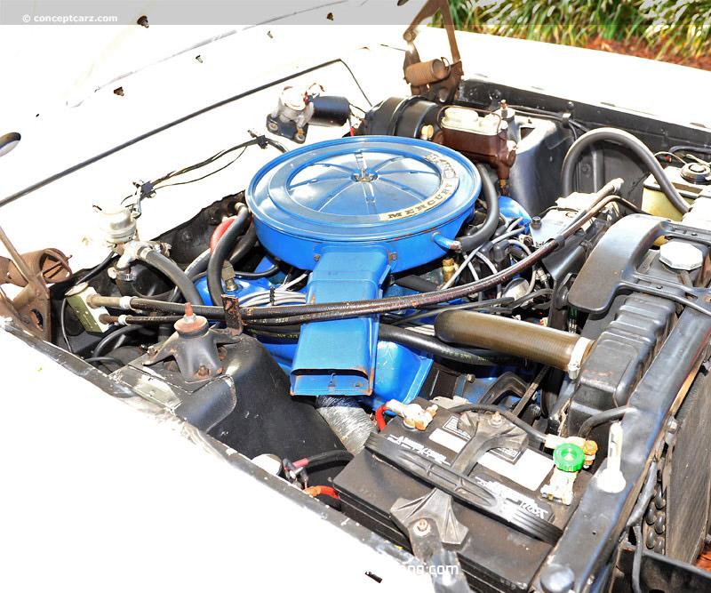

Cyclones

Sorry I went back after your last comment and reread your first post.
I read it as if you were asking about the color under (or bottom) of the hood "I found body color under the under hood black." rather than body color under the black on the inner fender panels and such
Yes this is a somewhat fairly common IMHO finding since the body color was applied first by hand.  Though not often visible unless the black top coat is damaged. Guess some painters got carried away or it was a new guy just applying a bunch of paint forward of the cowl where it would be hidden anyway by the black paint. At some plants the black did not extend over all of the front wheel wells so body color can be seen there on the inner fender panels

Having restored and documented many midsize Fords/Mercs, yes, the underhood was body color. And as far as the engine compartment went, like Mustangs, the body color did come forward and on the inside and outside and then the black out was put on. Remember, the amount of body color will vary from car to car and side to side. Different days, painters, hangovers, etc. I have done 3 Spoiler II's and now a Talladega. Apparently the black doesn't hold up well, that's why we see the color.
