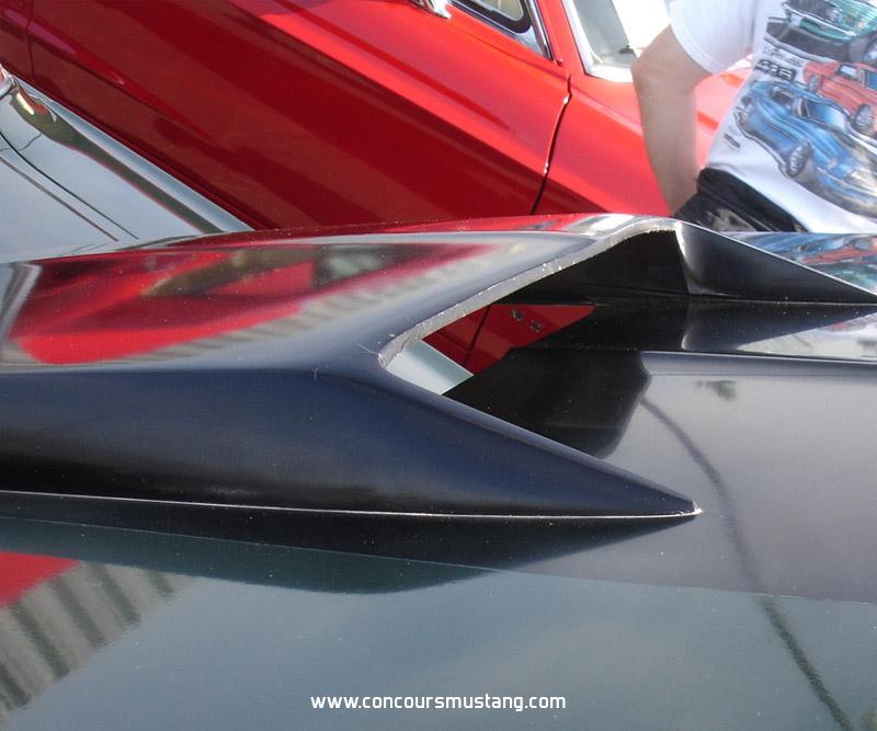

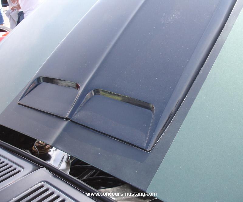

All of the original 1968 1/2 Mustang hoods that I have seen have been semi-gloss black.
The brittany blue hood in the attached picture is the origal from my late April Dearborn built car with (then) 26,500 miles. The two green hoods are from original cars and the attached snip from a feature article in the November, 1968 issue of Rodder & Super Stock magazine clearly shows semi-gloss even though they called it flat black.

« Reply #7 on: June 13, 2024, 09:39:10 PM »
 Another picture from an original late April Dearborn built 1968 1/2. The stripe is definitely semi gloss on this car.
  On the other hand, Don Fotti's mid July Dearborn car that I believe still has orignal paint appears to have a gloss black stripe so maybe there was a change sometime over the course of production.
Follow up: Don stated that his car has never been repainted. He has owned the car since 1972. Don stated that the glossy appearance of the stripe may be due to waxing / polishing the hood and stripe over the years.
