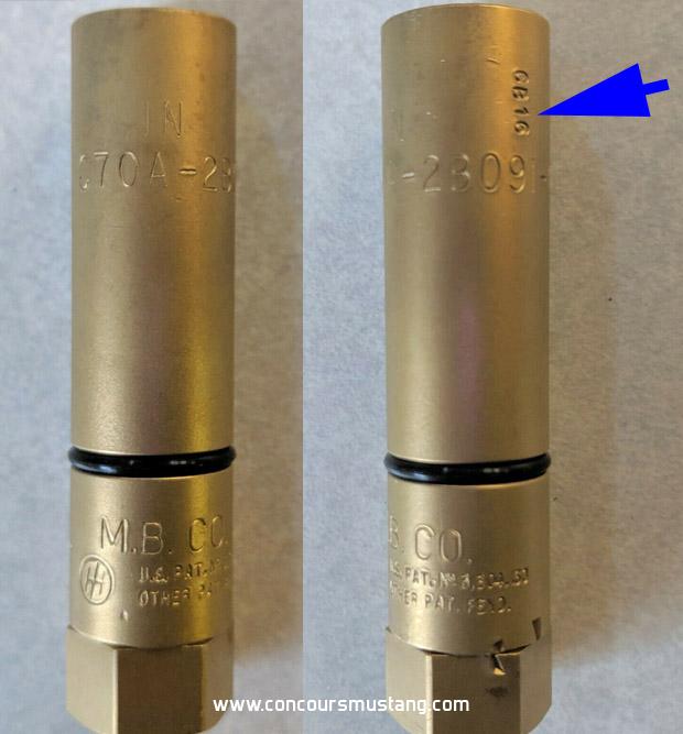

If your interested in the small details they were also dated - as to when the part was assembled. Happened to have a C7 example handy
