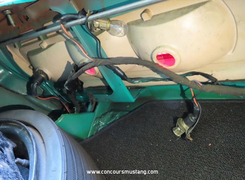

Just sent my original taillight harness to Rhode Island Wiring to have wrapped with the cloth covering (had very little on it if any at all).  Does anyone have any pictures of the harness where the cloth braided loom stops? When I  look at the "concourse" harness that shows available available it appears that it stops before the branch of the taillight bulbs? Any help would be greatly appreciated.

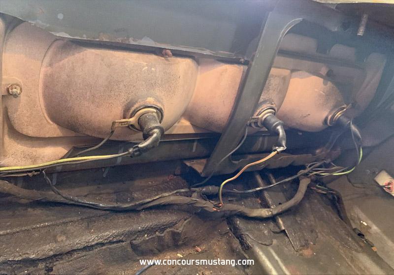

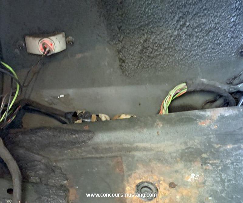

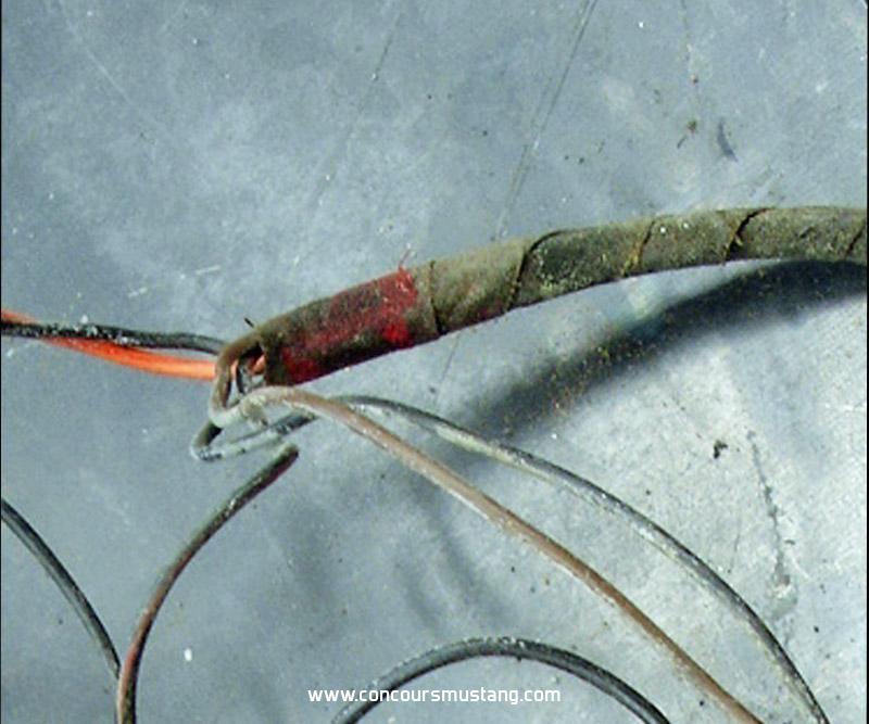

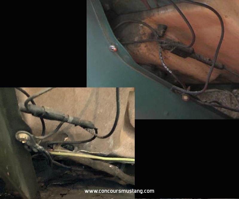

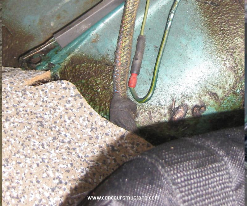

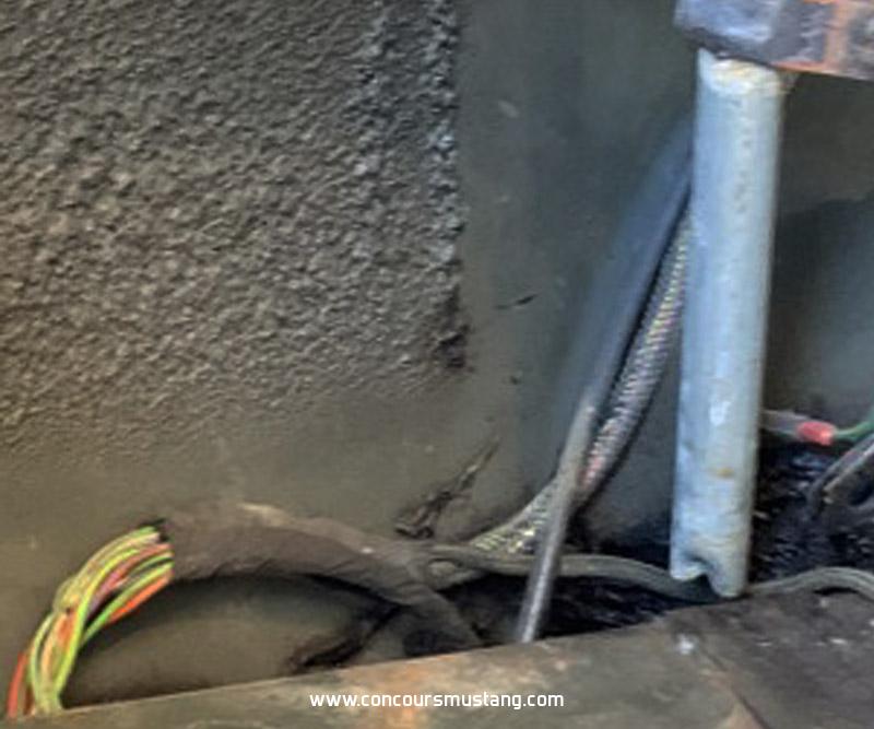

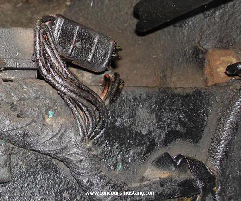

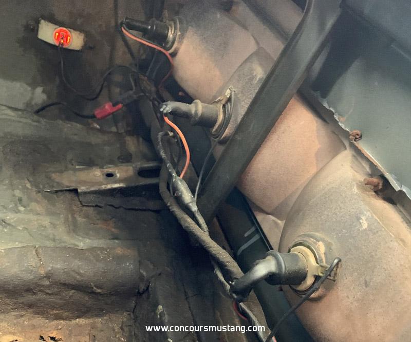

The loom is spliced at the base of the drivers side wheel well and is wrapped with tape at that point and only covers for a few inches before all the taillight controller parts are located then looking backwards the tap job continues to each bulb as it goes across the taillight panel to the rear.
The following pictures are from three different cars built through out the production period. In the first ignore the rattle can undercoating some owner applied
Difficult to find many pictures since in most cases the cars are assembled and the detail is hidden under the cardboard filler and the mat

Some examples
Starts and some stops
End of the wire loom passenger side with label
Center section at gas tank fill
And in between the ends.
Very Early
Much Later in the year
