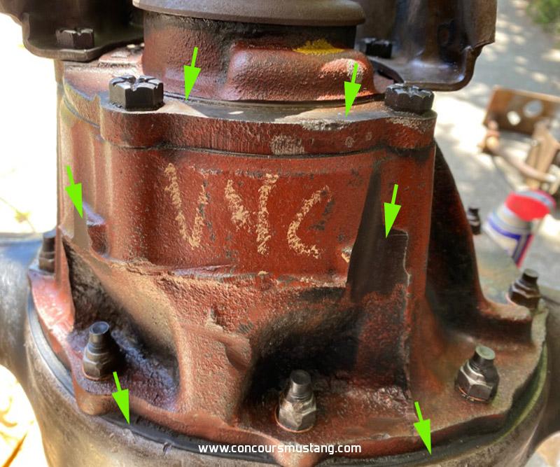

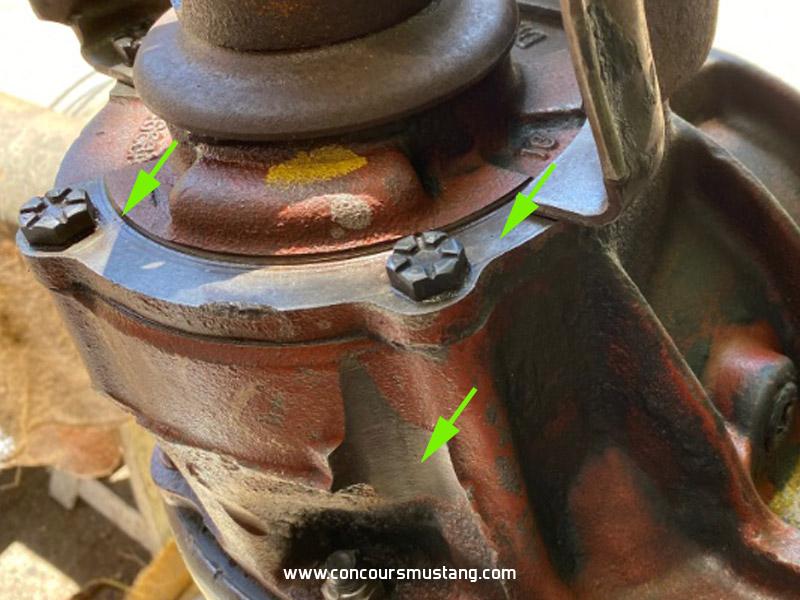

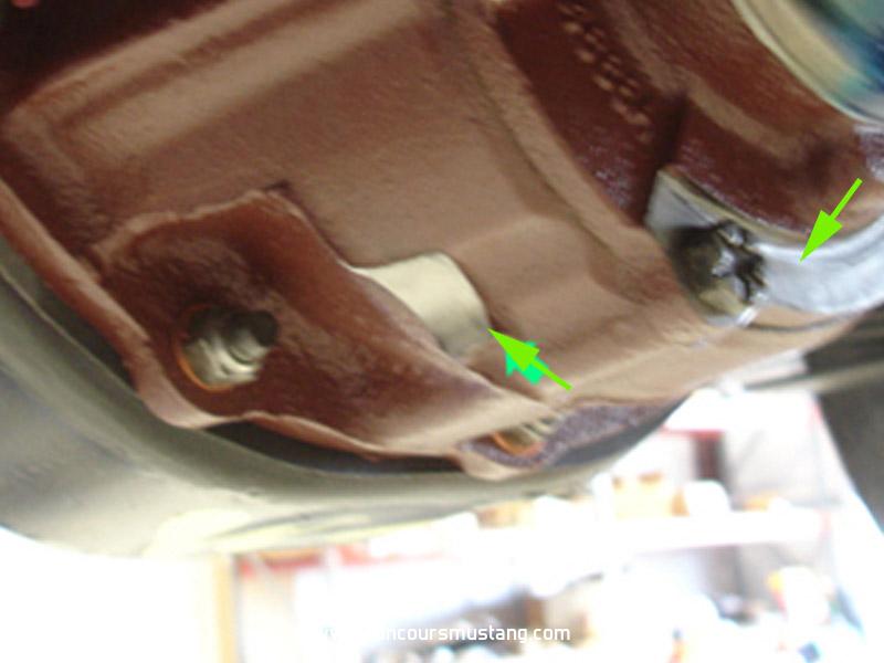

Here are three pictures of an original paint and finish 68 9 inch rearend and one restored to highlight the lower passenger side machined spot. 3rd member main case is dated 7L and pinion retainer 7H
Did include a couple of arrows indicating that the face of the housing was also bare steel where the gasket would sit
Hope these help
