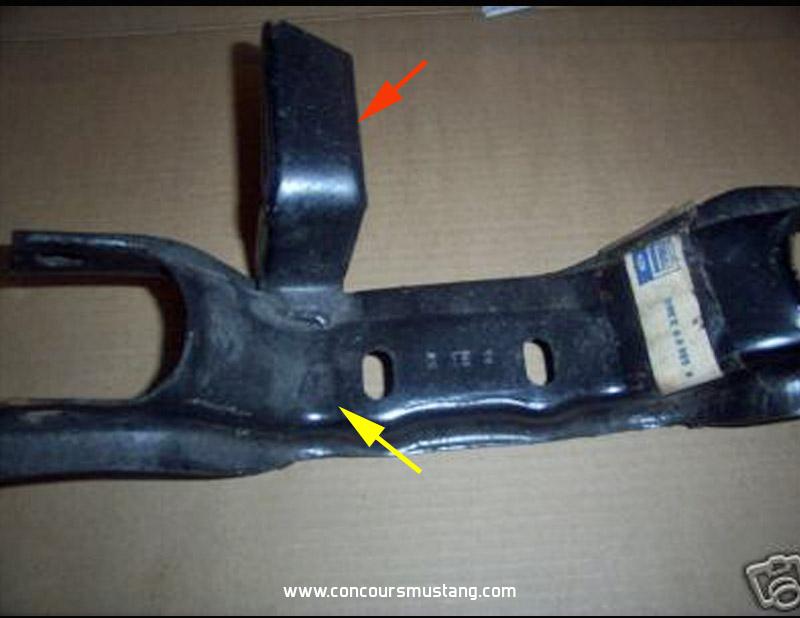

Some examples to illustrate trying not to get off the original focus of the thread so we might separate this off shoot of a discussion  :)
65-66 all transmissions - 2 piece. 1 arm for the E Brake attachment

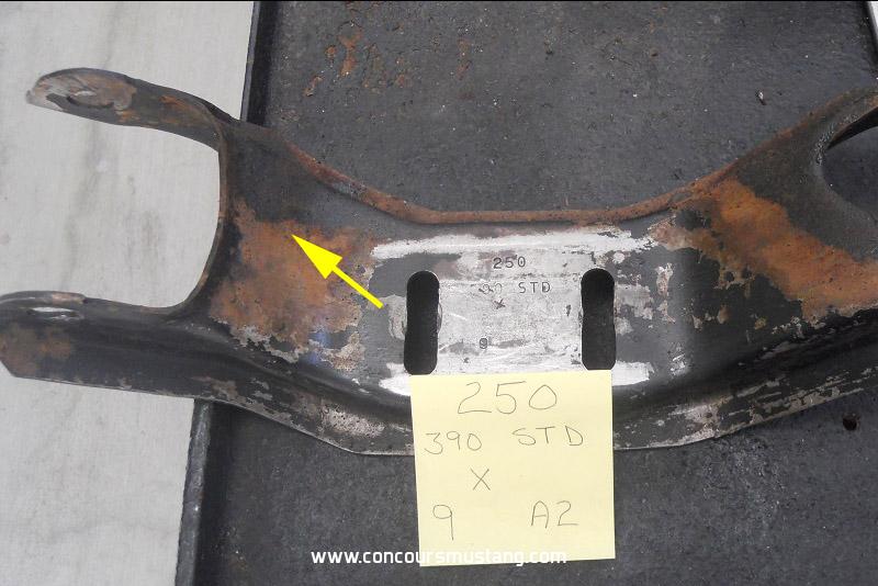

69 Manual and C4 cross member. This one was modified for the gear reducer attachment

Jeff and I have had long friendly disagreement on painted vs. painted and what was typical factory. Painted was typical on service replacement parts so that they would not show rust on the shelves. That may explain some.  In this case as I said before if any were painted (that weren't service replacement) they are in the vast minority.
