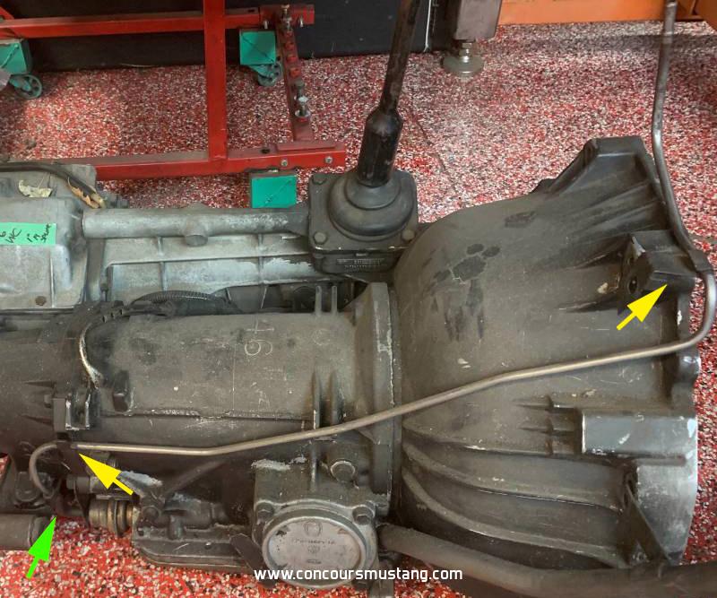

Hello
Can someone help with the vacuum modulator line routing?
My car is a 1967 289 base convertible with power steering as the only option. The brakes are manual and the car was built at the San Jose factory mid April of 1967.
The modulator line was missing when I received the car.  I purchased a line from In Line tube that had a 180 loop on one end with a fitting that was not correct,
this was the only line they had listed for the 67 mustang 289. I purchased a second line from Classic tube that they said was for the 67 mustang 289 that was completely different than the first line and has piece of rubber vacuum tube on each end. This line seems more correct but I cannot figure out how it should be routed. It seems the only way it will reach the vacuum modulator valve is to run at an angle across the transmission.
thanks for your help
Bob

« Reply #3 on: August 31, 2024, 09:59:08 AM »
You should check the assembly for a drawing. There are two clips that hold it, one on the bell housing and another on the RH side of the transmission.

Re: 67 289 mustang C4 Vacuum modulator line routing
« Reply #5 on: August 31, 2024, 06:26:47 PM »
Here is a picture. NOT a 67 Small block example but it does show the routing and the clips referred to above
As mentioned two sheet metal retainer clips
Yellow arrows. Pictures and discussion in the thread below
Green arrow. Rubber preformed (shape of an "L") connection hose
Guess you have figured out where the tube is attached at the engine end.
Clip thread mentioned above
https://www.concoursmustang.com/forum/index.php?topic=16403.msg102649#msg102649
« Last Edit: August 31, 2024, 11:06:30 PM by J_Speegle »
  • Posts: 5101
« Reply #6 on: August 31, 2024, 09:19:21 PM »
Here is a picture. As mentioned two sheet metal retainer clips
The image represents the correct routing for the modulator hose and retainers. Notice the Pre-Formed elbow rubber hose at the modulator. There has been discussions about this elbow hose in other threads.
I do wish to also mention the bellhousing pictured is not correct for a 67 Mustang.
Also, the modulator itself is incorrect for a 67, as a 67 is threaded in, does not use that forked retainer.
« Last Edit: August 31, 2024, 09:21:25 PM by 67gtasanjose »
