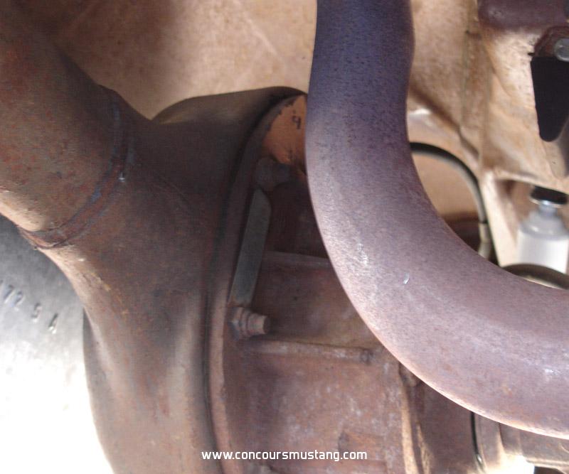

What would a correct case look like? Horizontal ribs???
Update, picture of rear in my car. Is it possible this is the original one???
Thanks, Pat

Of course check the casting dates on the center section and pinion retainer

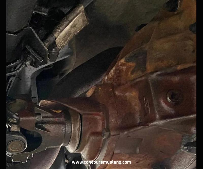

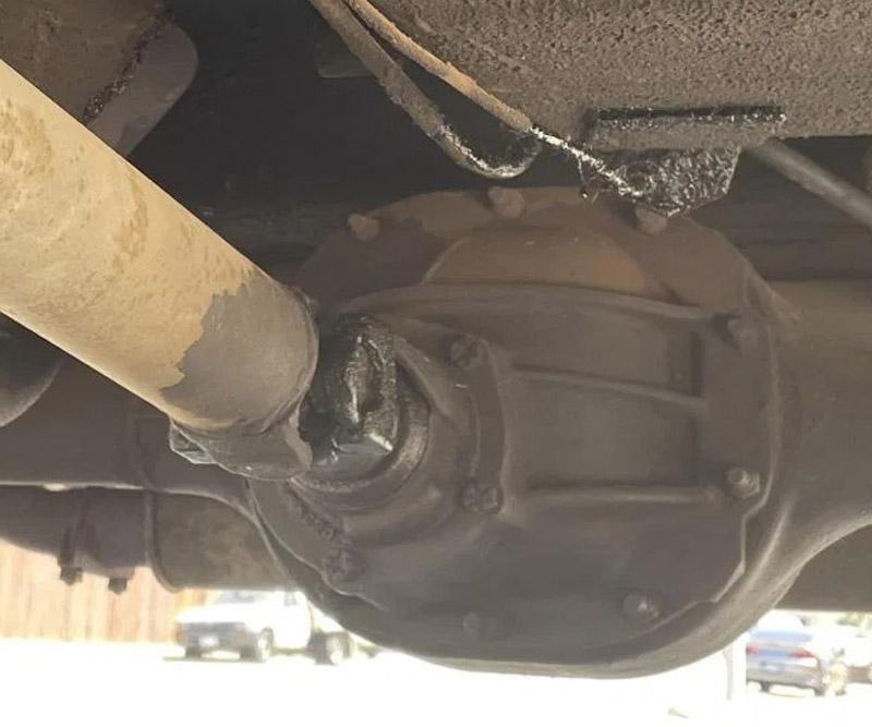

« Reply #2 on: October 08, 2024, 08:24:23 AM »
Thanks for the pictures. It appears the center section in my car is the correct type. I have doubts about it being the original one as the car was built in March of 1966 and the cast date is 3J3.

« Reply #3 on: October 08, 2024, 04:04:32 PM »
Yep  :)   Doesn't sound like a match
