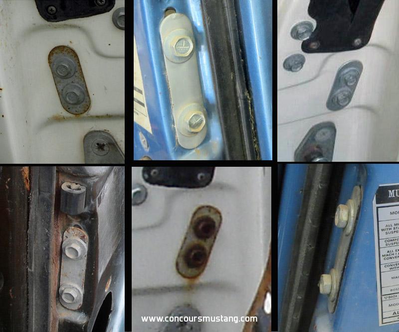

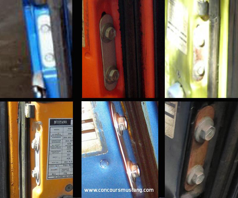

I've seen on unrestored cars the following Some much more than others depending on plant procedures
Body painted (on one side) plates mounted so that the body color is visible
Black or bare finish face visible
Silver plate face visible One some - like San Jose - they appear to be painted silver not zinc plated
As mentioned in another thread I believe some of the painted plates may have been missed (placed in a location during painting where the painter missed) may explain some of the non-body color ones or if the worker dropped the body color plate during installation they may have had a tub of prepainted (body color) plates available so that they could quickly replace the dropped one to keep things on the line moving.  This is likely IMO in those cases where we find one plat with no body color and the rest (1 or 3) finished with body color.
Hope posting examples from all plants in one thread gets confusing and generate cross talk. If it does may separate those discussions out by plant as usual
So for 70 San Jose built cars all I found so far is non-body color plates on unrestored cars
Looked at my collection of NJ build unrestored cars and again came up with no examples with what appeared to be silver finish. Found just the typical and sort of expected body color paint finish and a few where they were rusty. Not sure if this indicates bare steel, thin coat of paint (body color or other wise.
And lastly 70 Dearborn examples
From an earlier thread. Vast majority found with body colored paint. Few silver and possibly black paint
Today's examples since your focusing on silver ones it seems I've left out all the body colored examples but did include (at the far right) the unpainted ones it appears. May be able to establish a pattern if have more time and its important at this time

Ok thanks for the input...sounds like we are all in agreement.  Body color is common and there is other variations where the plate does not have body color on it.  Should not be a hard rule one way or another.
Would not agree with the bolded statement above. Don't believe at this time its correct. That would apply to Dearborn and NJ built cars but not San Jose
As far as judging you could for 1970's any of the three or four finishes. If you don't list them but list them it would open the door to any finish. List body color for those two plants and allow, during the introduction about anything different or unusual about that particular car, simply ask for documentation - a picture - of the car being presented. Or list for 70 Dearborn and NJ were typically body color then follow with the San Jose description. In this way your helping those that are restoring cars but started with a car that had been restored before or no evidence remained. If you don't then anyone building is just as likely to choose to paint theirs a different color even though their car likely was body color.  Sometimes owners, if given the option, will what is allow but not correct for their car simply to make things easier or to stand out and be different. One example would be all the 69-70 Dearborn cars that are built and shown with red oxide undercarriages. The answer, when asked about the color typically respond that even though their cars were not painted that color they made that choice because the rules said they could without deduction. Had two such examples last week
That's the challenge of trying to cover all the bases in such short spaces on the sheets or you need to assemble a resource guide that the judging sheets could refer to in a short single few words.  Been discuss over and over again since the 80's in MCA

Marcus it was a discussion on cowl blackout and as a sidebar when the window stop plates were actually painted. I can understand aesthetically why they painted them body color but from a production and engineering point of view it made no difference and possibly complicated the assembly process. I can only imagine how many were dropped or lost during the process.
From what Jeff has posted (VIN data and body color, silver or black) it looks to me as a summary of the current data presented:-
Dearborn:- Early 1970 model year production were body color but sometime around early December 1969 they switched to being predominantly silver.
San Jose was silver.
Metuchen was body color and switched to being black during October 1969
