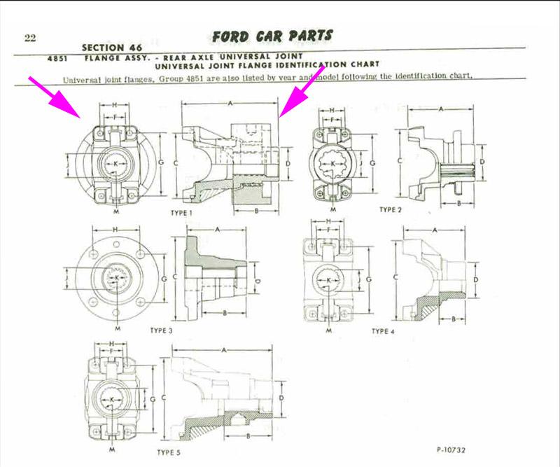

Well its not a yoke that would typically have been used. Have seen these on trucks and commercial vehicles
Since you know what your car should have the challenge is this odd one. Suggest that you get all the measurements since I don't think you will find an engineering number on the part and compare those details to what is listed in one of the MPCs. Believe the section starts with diagrams of a side view then follows up with pages with the specifications. There are likely 20 or more applications and a number of different variations that can't be determined just by looking at a picture

« Reply #7 on: November 19, 2024, 11:52:05 PM »
Here is the start page with the drawing I was referring to. That should give you a start at least
