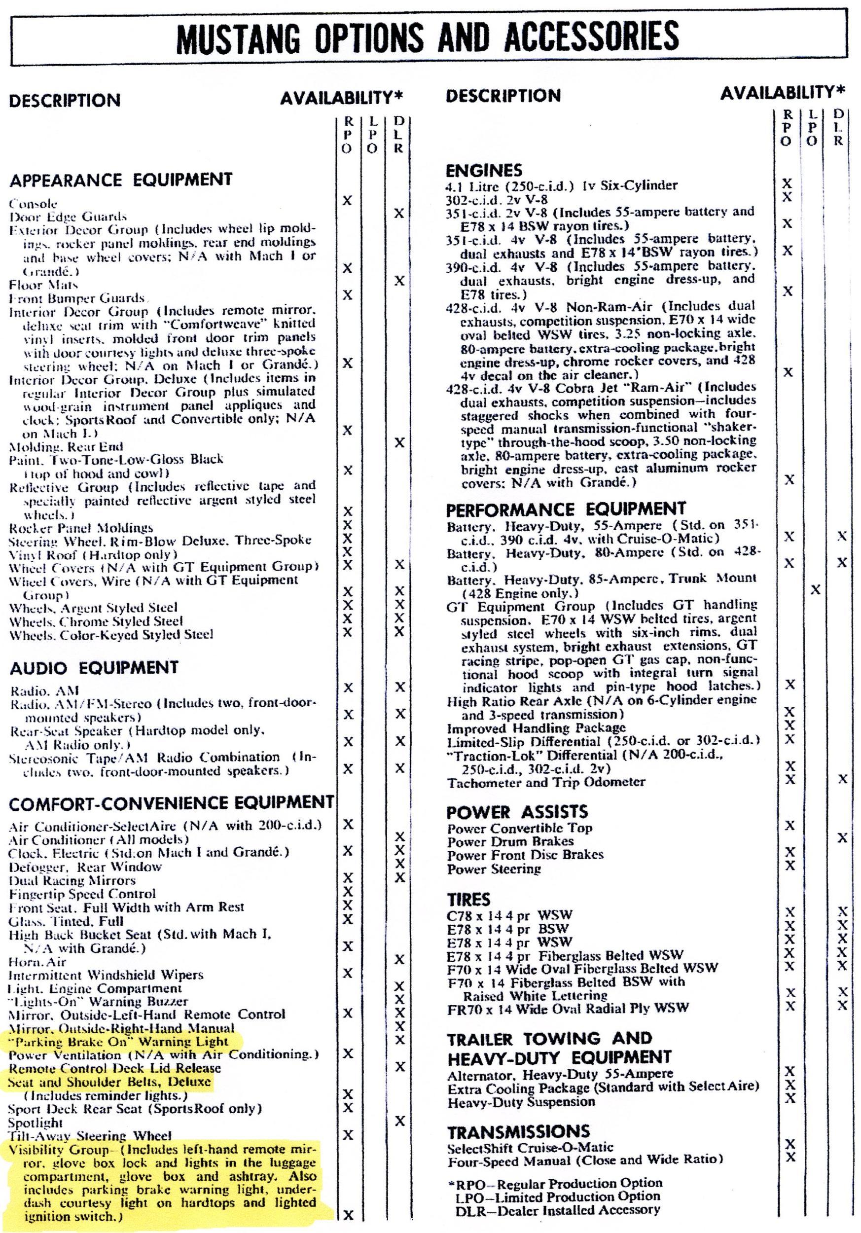

My '69 Q-Code Convertible came with a seat belt warning light , but the Deluxe Belts/Warning Lights option is not included on the Marti Report.
My original lower dash has the 2-holes for the seat belt warning light and parking brake warning light ... and the wiring harness includes wiring for both.
Could my Marti Report have mistakenly excluded the Deluxe Belts/Warning Lights option? Were the Deluxe Belts/Warning Lights option included in the Interior Decor Group - Deluxe?
Thanks in advance.

It may have been part of the Visibility Group option.  My CJ Grande' had both lights but the Marti listed both the Deluxe Belts/Warning Light and the Visibility Group.
