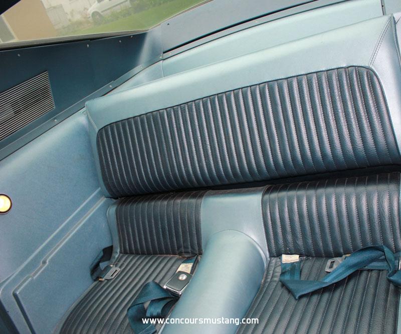

I am a bit confused about the dark blue in a Fastback on the rear upper interior parts.
I understood there are two dark blue polys listed from Ditzler/PPG, one being the 13056 number used with the light blue 13004 while in another thread here another flat dark blue is mentioned:
https://www.concoursmustang.com/forum/index.php?topic=23734.0 (as color number 13540 dark blue poly flat) - probably those are the frontshield moldings?
The light blue was once replaced on all my interior parts  from the PO (a paintman) (and just painted over the dark blue pars while in the car from a PO), but when I look at the not painted areas it looks really dark matte. What is the difference between the two dark blue in reality - flat and shiny?
Another question: Do the interior fastback panels have original overspray or paint on the rear (facing the metal body)?.
Shall I follow my found dark color.
On restored cars in the US car shows always saw slightly lighter dark blue metallic and a bit more shiny than flat being used like below, which has nothing to do with a flat matte dark.

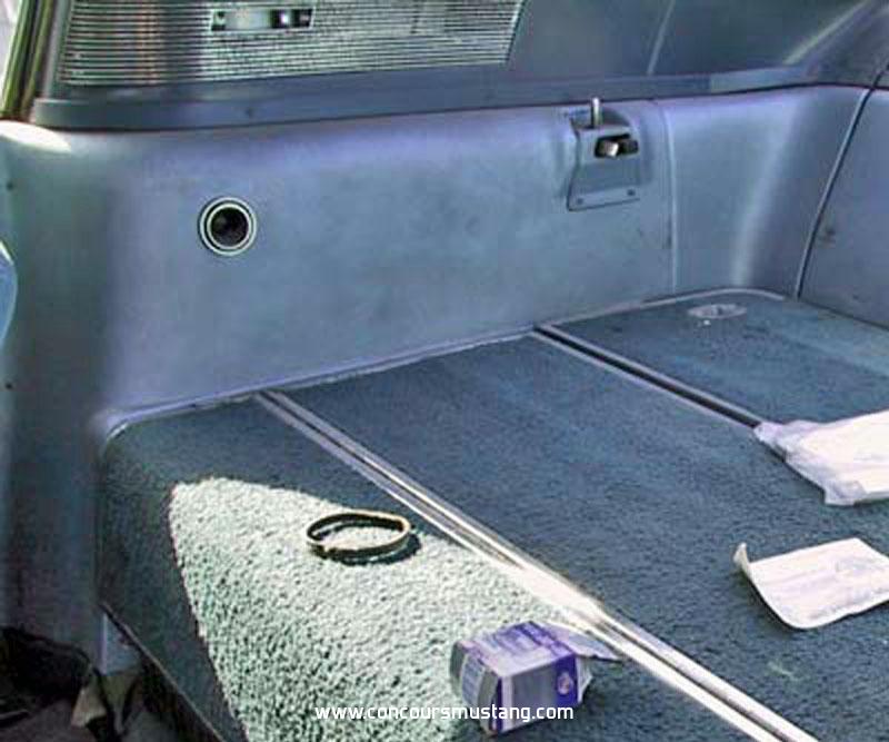

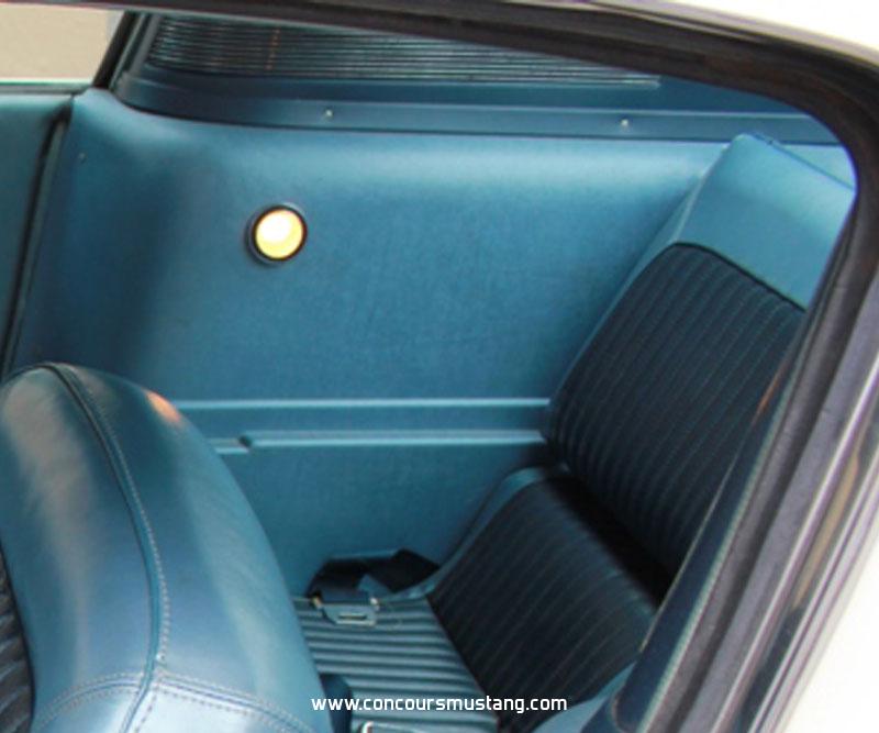

  • Posts: 24915
Re: April 1968 J-code FB 2B interior - the dark blue question
« Reply #3 on: December 03, 2024, 10:15:47 PM »
Agreed - darker on the blue interior  (and a couple of other) 68 fastback interiors .
Here are a couple of unrestored examples. Remember color tint and tone are hard to judge in pictures, because of monitor and camera settings as well as lighting
Hope these help
