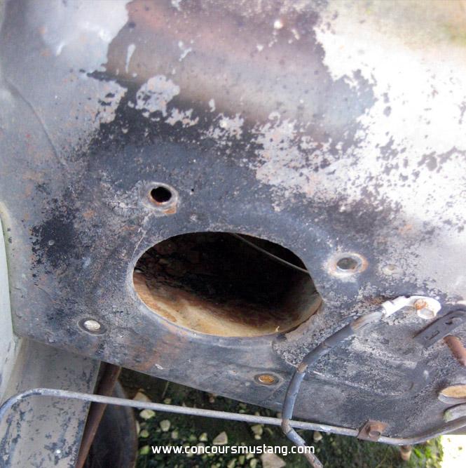

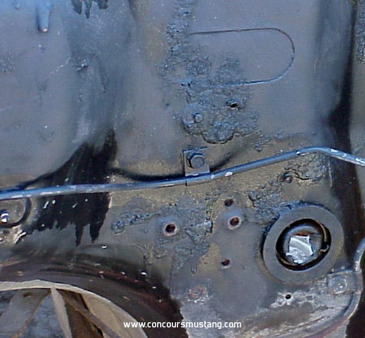

Re: firewall holes
« Reply #3 on: December 05, 2024, 03:57:20 AM »

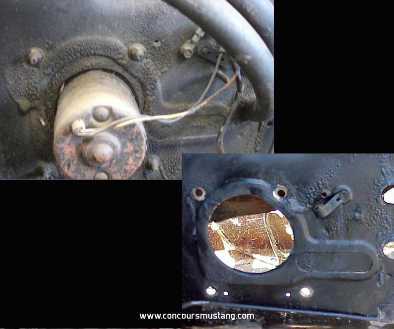

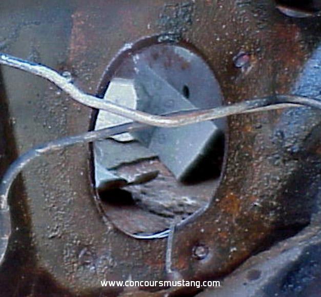

As for the AC modification to the heater motor opening here are a couple of examples. Going to be tricky welding a piece where the cut out is or was since there is a bend in the sheet metal and would be difficult to get a grinder in there to finish if you just did the insert. Instead considering finding a donor and splice it in on top of the raised edge or around a larger piece where the metal is flatter and easier to refinish so that the repair is invisible

Hi: Car was built on 10-21-66 at San Hose with S-code, factory air, C6 trans, power disc brakes. From pictures looks like all cars had the knockout plate and was removed for air cars. Thanks to all

« Reply #5 on: December 05, 2024, 11:29:18 AM »
In reference to my post about repair you can do the repair by tack welding in from the back side (interior side) of the firewall to give the proper knock out look . Of course you can do it your way but it is a lot more work .

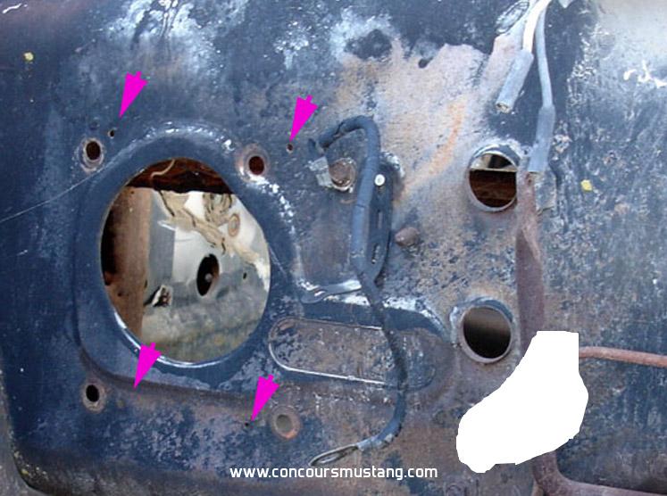

Re: firewall holes
« Reply #9 on: December 07, 2024, 05:14:43 PM »
Thanks guys for helping out.  196667Bob agreed someone put in some work doing those pictures. Unfortunately both resources don't represent all of the holes nor the differences between different options
Not anyone's fault just some are skipped, have sealant applied over them, missed or not clearly visible in the products shown or mentioned.
Still not exactly sure if the OP has an AC or non-AC equipped car so will stick with non- AC. We can always cover the AC related holes and changes. Just to keep the confusion down as best we can. Since there were some holes made at the stamping plant which would make those standard (can't recall if there was more than one plant stamping these) while holes made at the car plant can vary some since not all had guide divots provided
Here are some pictures from non-AC cars without PB.
Holes around the steering column opening

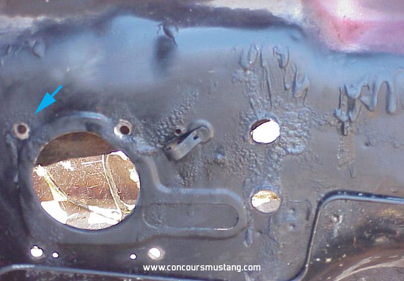

Holes around the throttle arm opening - V8

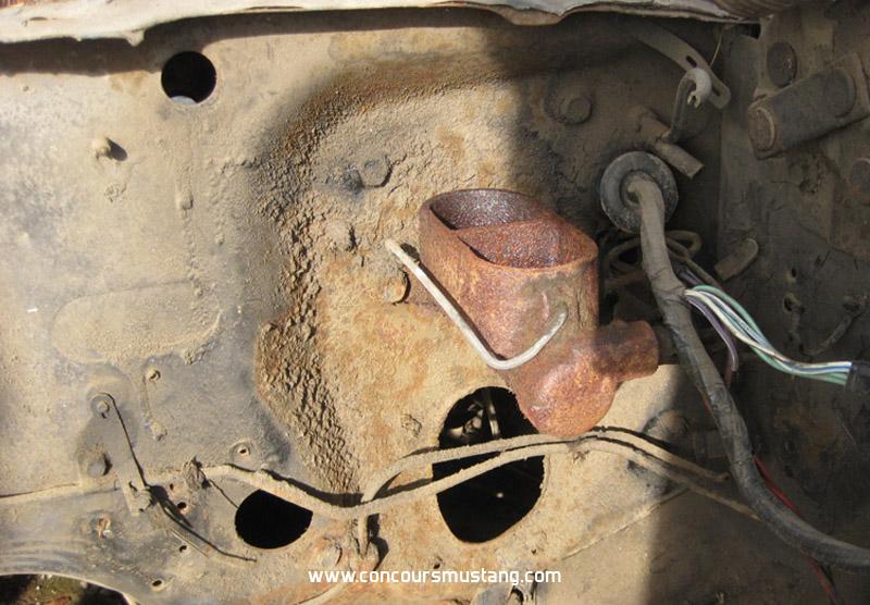

V8 Automatic equipped master cylinder side

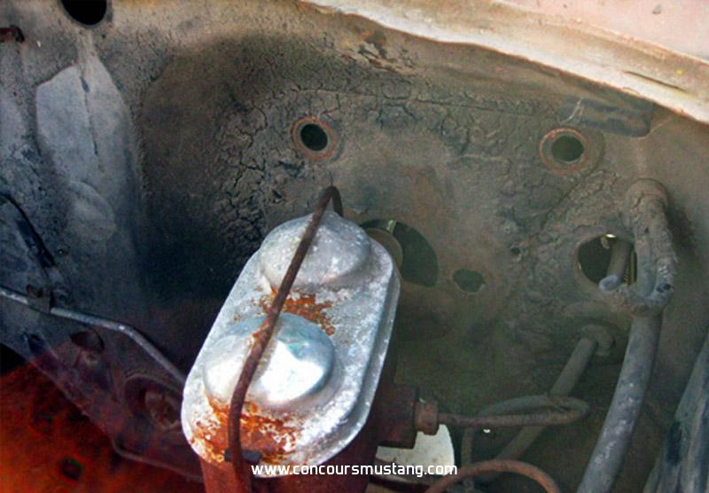

Another look from the same application as above. Some are hidden or covered with sealant

Re: firewall holes
« Reply #10 on: December 07, 2024, 08:09:44 PM »
I did that on my 65 and it worked great. For extra credit I later used this hole for EFI and the tack welds broke correctly.
Two-fer.
