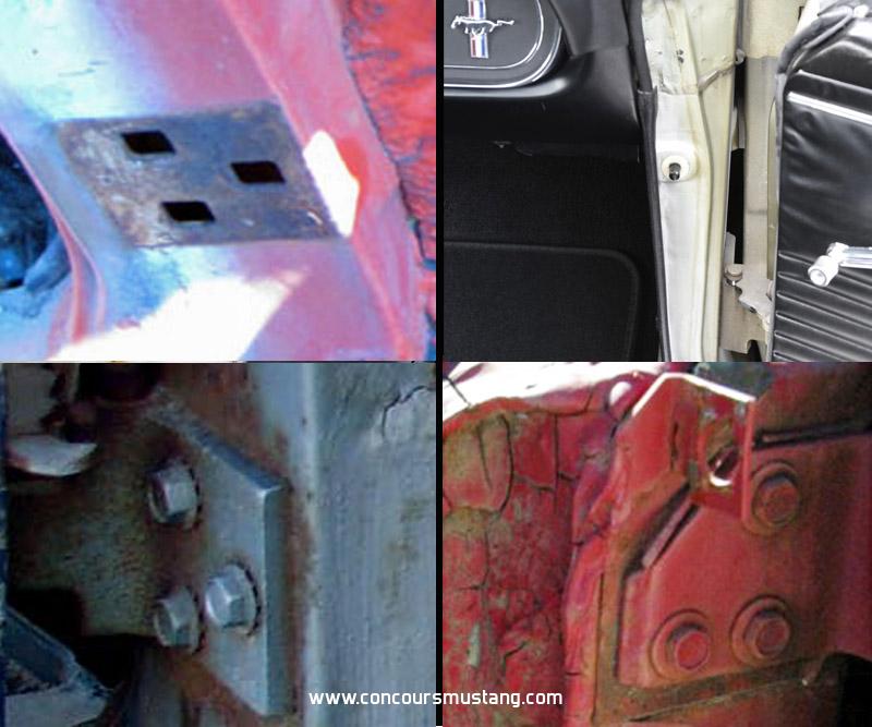

The door hinges (believe that is what is being discussed) were attached to the outside of the unibody between the door and the A pillar not in the interior so they would be body color. Just like what was done in the trunk with the trunk hinges.

Should be a fair number of examples in the Unrestored picture section of the sight where the picture includes a shot of that forward door jamb on either side of the car such as these examples
And a group of pictures from four additional examples to illustrate comments above

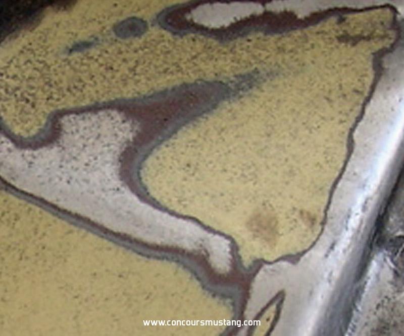

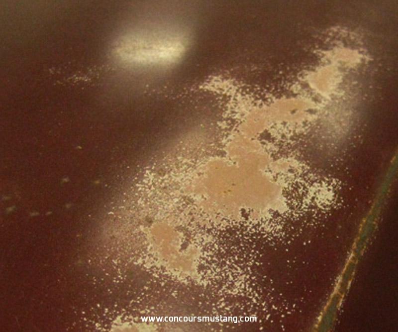

Thought I mentioned that above but anyway - a red oxide primer (not like what was used under the car) then on the exterior surfaces a light grey primer surfacer no matter what the exterior color was.
Couple of pictures of original paint cars showing all three layers
Dark exterior - Vintage burgundy That's red oxide color not rust in the center of those larger areas
Light exterior color - Springtime Yellow. Sorry for the sanding dust
