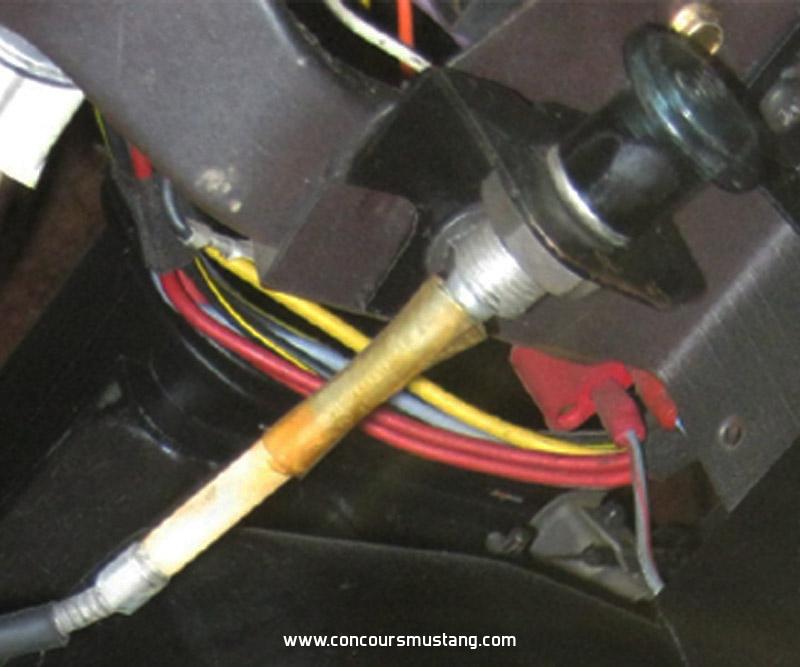

To the right of the steering column would be the location of the knob typically.
Since the car in your signature didn't get a manual choke guess your working on something else.
And since you didn't mention what plant the car was built at I'm going with a 70 Dearborn Boss 302 for the sources shown below
Here is an example showing the location of the mounting

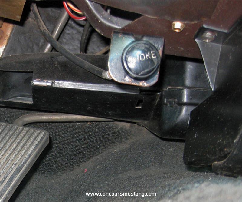

 My cable sits on an angle as well (the words CHOKE do not sit flat) and I can find no humanly way possible to correct it. Were they meant to sit like that and Ford was messing with us OCD people? Mines from a Nov 69, Dearborn Boss302.
Brad
Re: 70 manual choke cable with bracket
« Reply #8 on: December 18, 2024, 10:14:13 PM »
Brad
Not unusual to find them simply off just a little bit from my experience. Apparently they were not going to take the time to rotate the cable inside enough for the cable to site perfectly - except maybe for magazine or ad photos. If someones sat perfectly guess they were just lucky. Now if it was upside down or say 90 degrees off I can see a buyer asking for that to be corrected. Just depends
