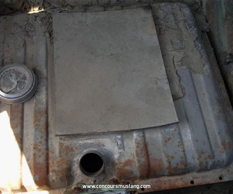

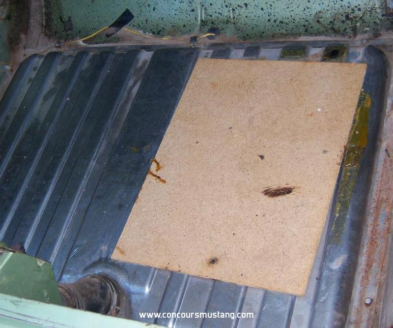

Does anyone have the dimensions of the masonite board for the gas tank?
There are a couple fo different sized boards used through the years so you will need to focus on the larger version. Believe there is at least one thread on the subject and I believe someone measured one or two but don't think those were 69's
Here is an original example from a 69 San Jose sportroof (top) and a coupe (bottom). Convertible and coupes used the same size board at that plant that year. Don't have one to measure at home but you could easily estimate the size using the pictures and top of the tank as reference points
