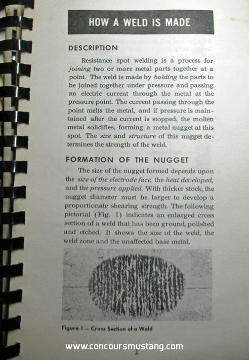

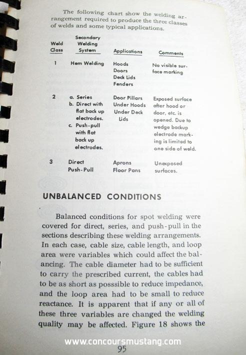

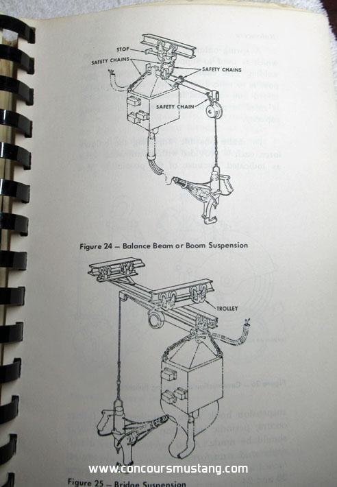

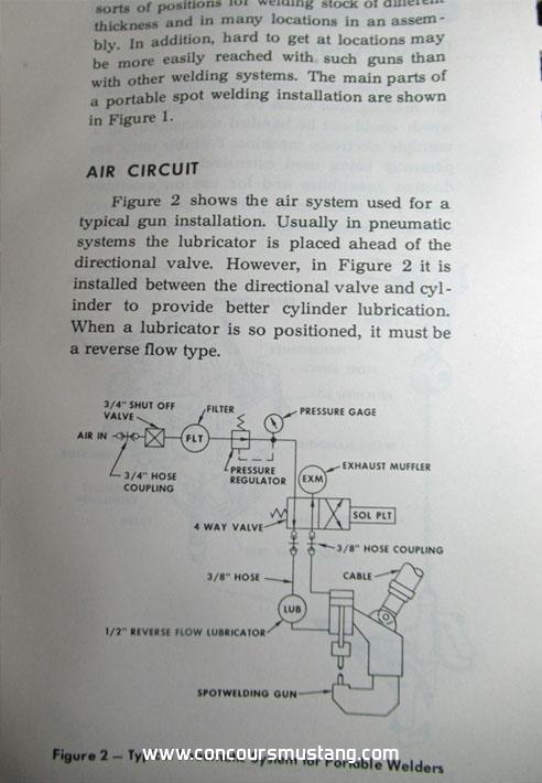

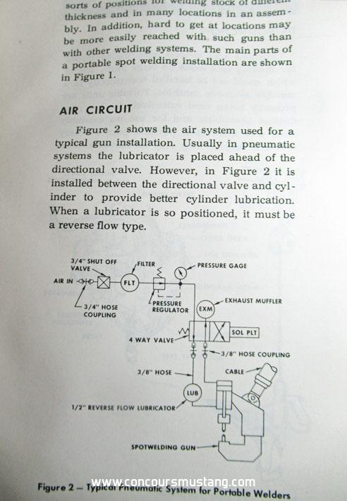

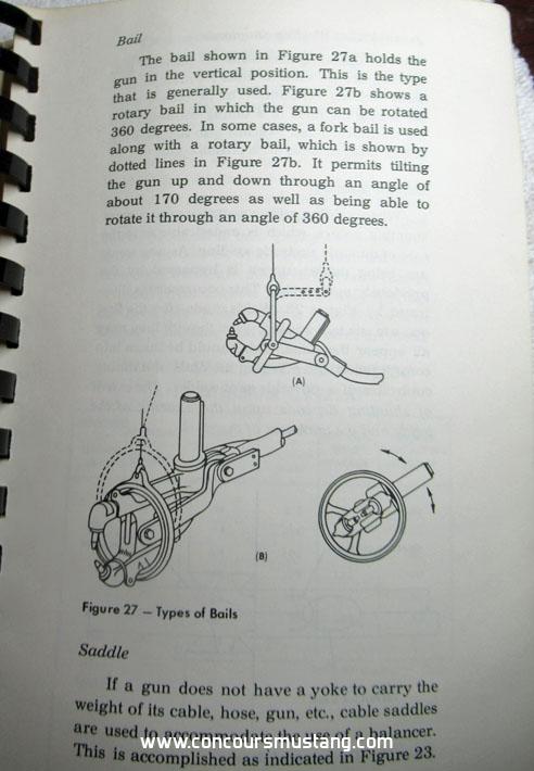

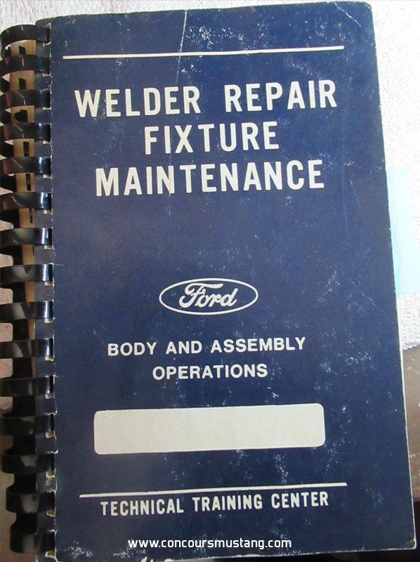

Re: Spot weld classification standard
« Reply #9 on: January 20, 2025, 05:38:09 PM »
Wished I could have found time to photo and share a few pages from the manual earlier but here goes.  Picked a few that touched on topics brought up in this thread as well as a few others related to the hand welding fixtures, thinking that might be of  interest to others that may find and read the thread. Believe it would be difficult to find another copy, not something of high interest to many people, no pretty flashy color pictures of cars and such, but who knows. Just knowing that they were published and having a title should help a lot in doing in conducting search for a copy
Hope these help you and others reading the thread

Offline RickP330
  • Posts: 27
« Reply #10 on: April 06, 2025, 07:32:05 PM »
Jeff,
That is fantastic, thank you!
It might be a big ask, but if you are willing to trust me with it - I will scan it in and share a copy so we can put it in the library.  I can send you a flat rate box to send it to me in and return.  I did a quick search on line, and only later versions of that book come up.
Regardless, I will study what you posted and absorb.  Thank you!

Offline RickP330
  • Posts: 27
« Reply #11 on: April 06, 2025, 07:38:56 PM »
Well that certainly settles the question of what the weld classifications are!  Thank you Jeff!
