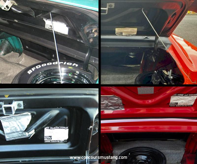

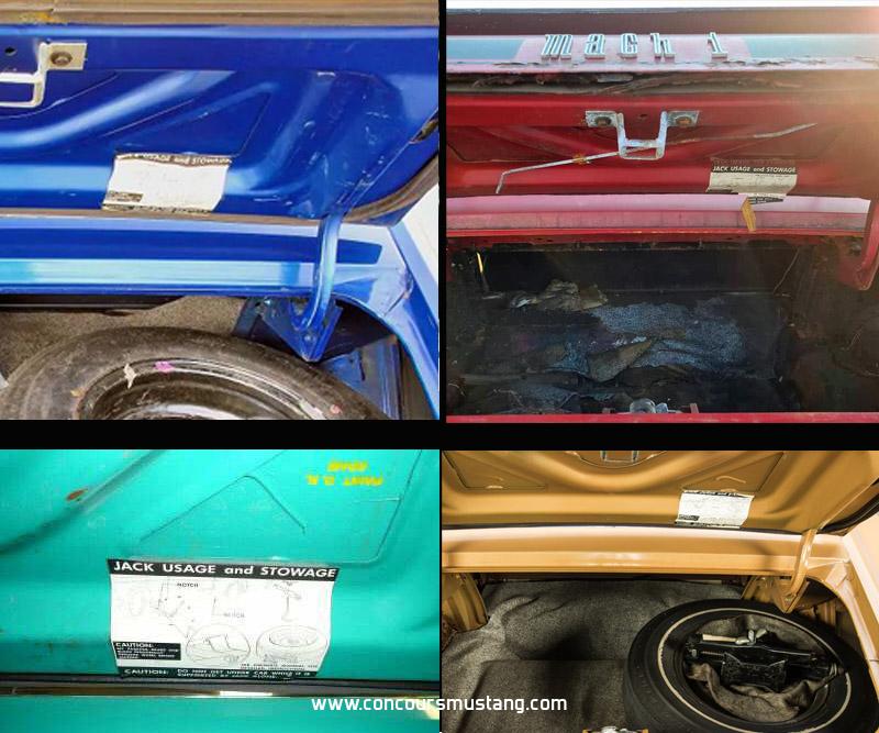

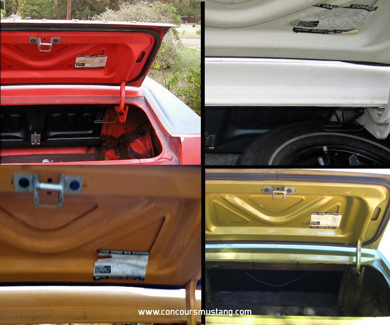

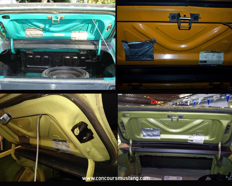

Here is what I found on cars with original trunk decals
70 Dearborn with spacer saver tire & wheel
70 Dearborn without spacer saver tire & wheel
70 NJ with space saver spares
70 NJ without space saver spare tire & wheel
Likely have a number of more since I stopped each search after finding the first four of each
