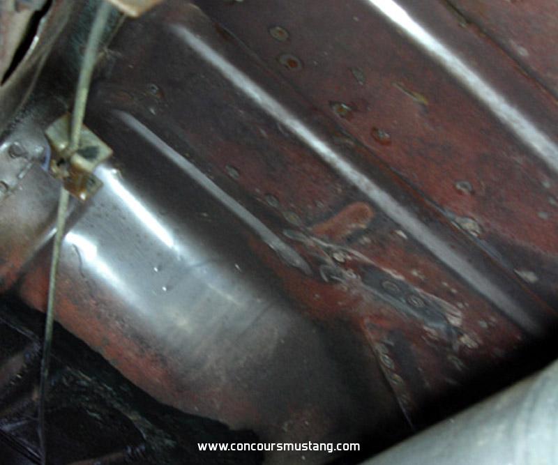

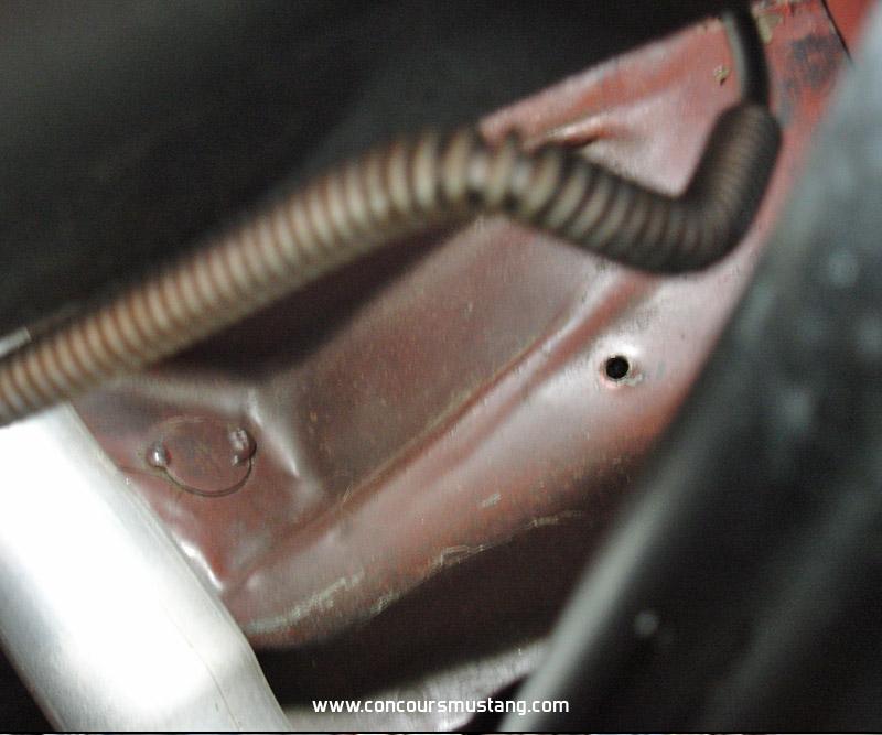

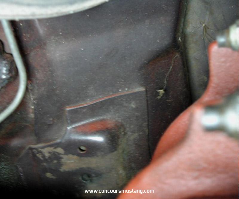

Yes I can confirm that red oxide was used during Dearborn production in the month of April 1969 on the undercarriage floor from the firewall rearward. We already have confirmed that it was also used firewall forward on the vast majority of Dearborn built Mustangs and Shelbys that year until there was some testing of what they thinking about using planned 1970 production
I've identified some cars built during October 68, Dec 68, Feb 69 and possibly April 69
Of course close careful cleaning and looking for the original color (down to bare metal) in those spots more protected from the elements is always the best place to start.
Here is a group of red oxide painted floors and the related general production period that I've posted before

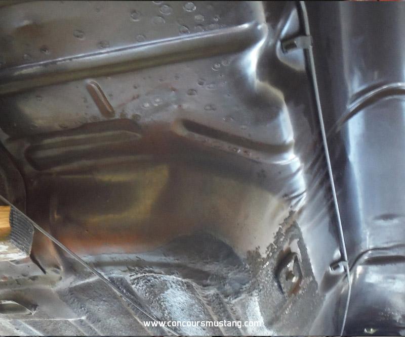

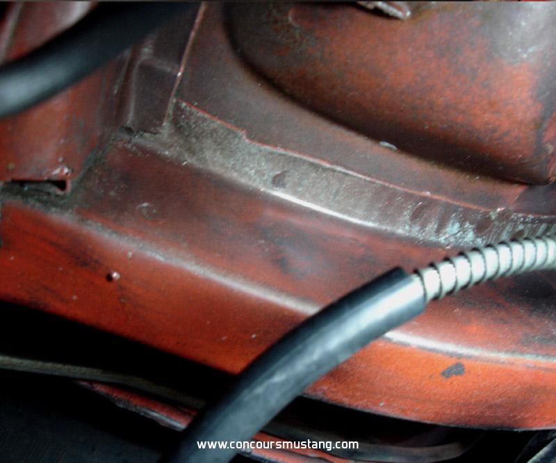

Now looking at the example from April could have been a reddish batch color as mentioned and shown below. the other 5 or 6 cars I have from mid to almost the end of April were just reports and I got no pictures with those reports and postings.
And to illustrate and example (similar I would guess with what Bob has witnessed) where the number of reddish color cars the day before was greater than norm creating a reddish batch color used on a small group of cars.
Hope this helps  and yes it would be good to get some pictures so that they can be fully examined and compared
