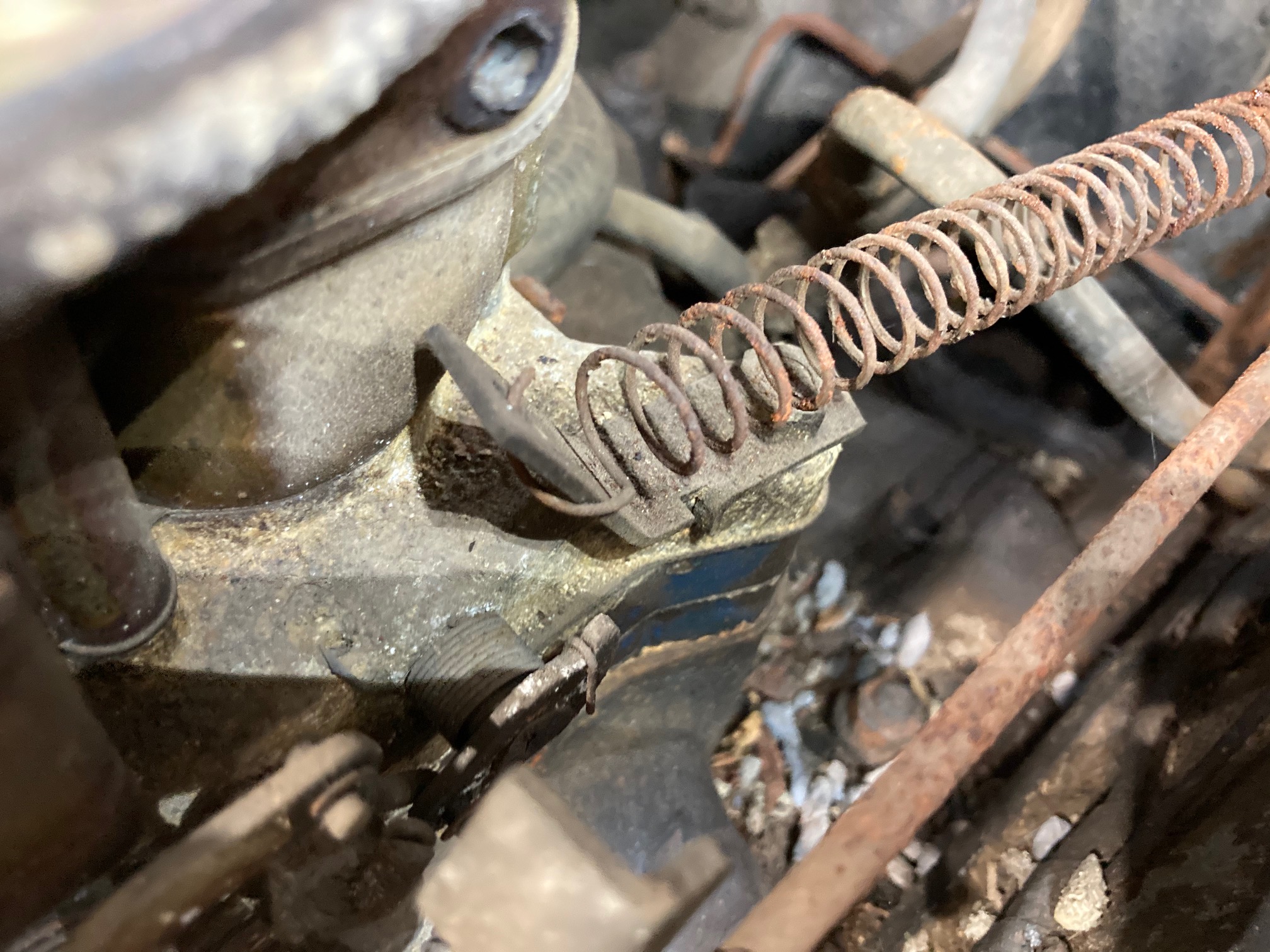

« Reply #2 on: April 13, 2025, 11:10:04 AM »
Here is an unrestored picture. I believe the spring was green. I am not sure if the bracket was plated or phosphated

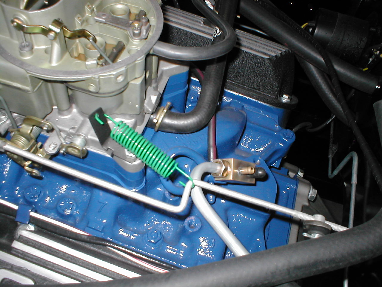

« Reply #3 on: April 13, 2025, 11:11:23 AM »
Here is one I restored

Pete,
Those are what I've seen on Mustang and Cougar J-codes. What I have found leads me to believe the brackets were cadmium plated. I checked your web sight prior to posting, but did not see the spring and bracket mentioned.

Re: GT350 THROTTLE RETURN SPRING AND BRACKET
« Reply #5 on: April 14, 2025, 07:18:06 PM »
There is no reason to believe they are different from the Mustang. Not sure the green color is accurate either.
These seem to get tampered with a lot

« Reply #9 on: April 15, 2025, 05:22:06 PM »
The brackets in Petes pictures and pics 2,4 and  6 Jeff posted (#4 is rotated backwards) are correct for J code. 289 2/4v and 302 2v used different  On the springs there were 2 as per assembly manual , Green for 4V 4 spd, blue for 4v auto however I've seen several unrestored autos with green
