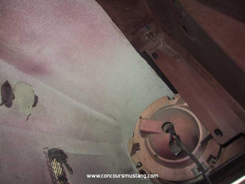

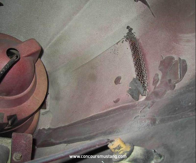

Re: 69 Shelby front fender air vents and side air scoop vent screens
« Reply #5 on: April 08, 2025, 05:42:43 PM »
A couple of pictures that have been posted before in other threads/discussions.  Product is similar/same as what was used on the vent screens at the hood openings that got the screen.  Pictures of those are visible in another thread sor use search to find them
