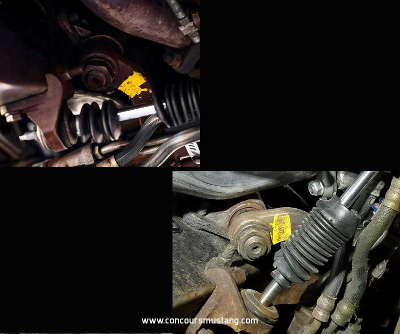

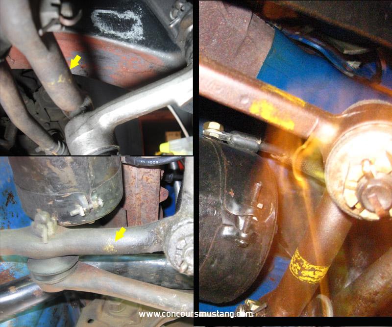

- Idler, pittman arm, steering center link - Strong yellow stripe applied by hand

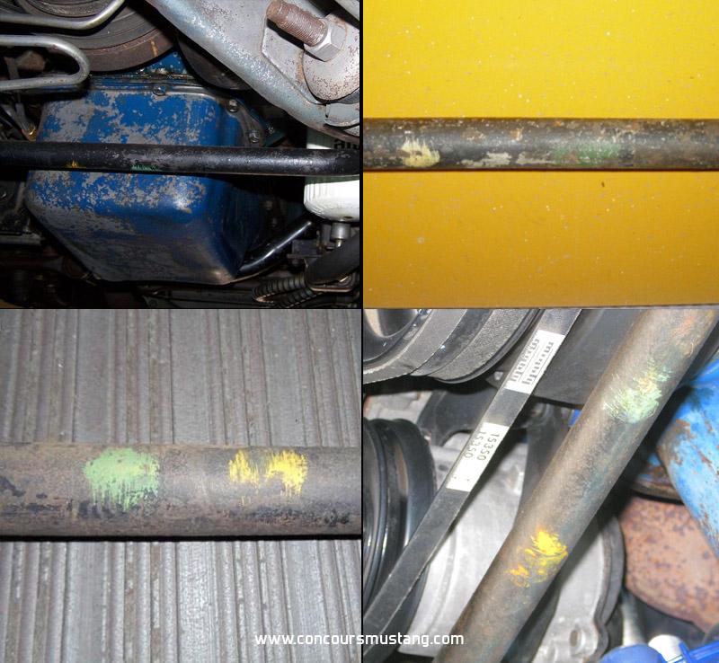

- Front sway bar

Examples of how and where most of the paint markings listed on your buildsheet were applied. Pictures were used in other post in other related threads
