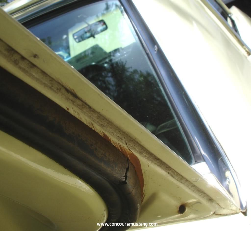

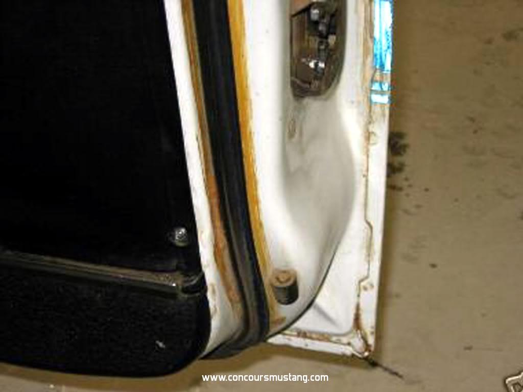

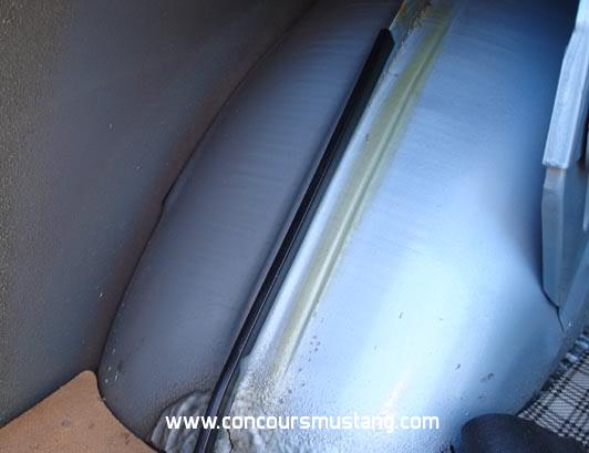

An often seen mistake we see on the show field is the use of black weatherstrip adhesive on classic Mustangs and Shelby's
Originally a yellow brush applied product was used. We can see evidence of it on original cars around the door weatherstripping, trunk weatherstripping and even the luggage protector strip on the drivers side wheel tub pinchweld in the trunk.
Not all of them are messy originally, but typically they never "stayed within the lines" all the times on any car. These pictures just illustrate those incidents.
