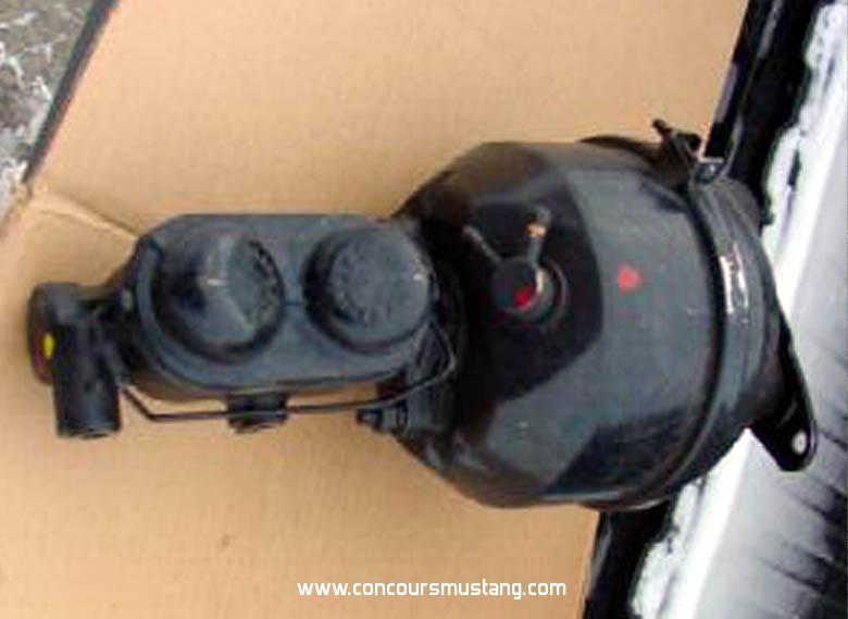

Looking for a photo of an original brake booster for a '67 (Metuchen April built A code) and what markings identify it as such.
Looking at the pictures it appears that Midland-Ross was the usual provider for power brake boosters for NJ in 67
Reread the documentation and the Shelby letter identifies a specific car as being the first car with the full (booster and check valve) fix. Cross referencing that cars actual build date I found that it was completed on March 7th - much earlier than the date indicated in one of my earlier posts.
So since your April build date is later I would expect that the original master cylinder in your car would have both red daubs. One on the top of the booster and one on the check valve. Both over the semi-gloss black paint that was applied to the whole assembly as a unit
It would look like the campaign (recall) unit that was installed on cars built prior to that date when they came into the dealerships as requested. Yes :) I know its not a disc master cylinder but the booster marks would be the same

« Reply #8 on: July 06, 2015, 06:40:49 PM »
Thanks for the pic and info....I believe the second connection on the booster check valve would be for the automatic transmission vacuum line.
