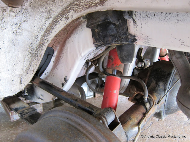

Did Shelby American do anything to coat or treat the area that they cut and welded the new bracket for the rubber axle bumpers?  Also did the put any coating on the brake ducts in the wheelhouses?

Dan,
I have always since black paint sprayed on the areas where the brackets were cut and welded.
The brake ducts in the wheelhouses vary.  On the earlier cars, the ones I have seen were originally installed from inside the car at the wheelhouse.  On the really late cars, I have observed them installed from the the outside with no additional coating applied.
Blacked out area at rubber bumper bracket.  This is an original, unrestored example.

Thanks Brant.
In your examples the wheelhouses were not blacked out.  Is that common?  Is it acceptable to have them blacked out?  Were they done both ways?

Black-out of the rear quarters would most likely only happened if a dealer applied undercoating.  Brant's examples are correct as the cars were made.
If you look at the list of parts that is out there showing the parts used to convert a 66 Shelby there is a line item for black spray paint that a worker attempted to apply over the welded and freshly cut surfaces. Normally they missed some like ( in 65 ) the results of the welding of the spare tire mount - not a 66 thing ;)
