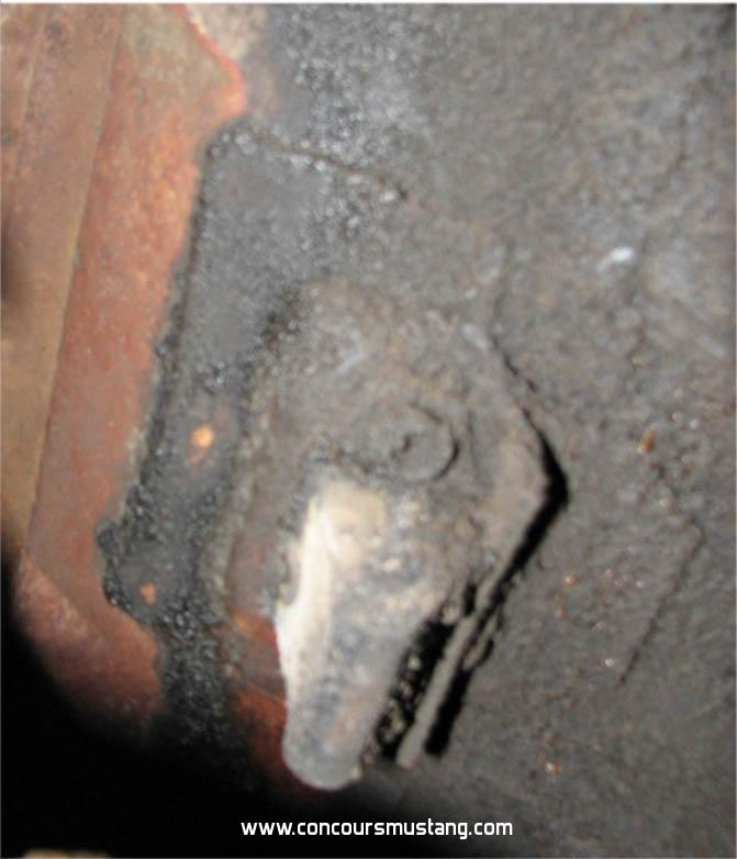

Picture of the snubber plate:
     The original poster never got an answer to his question.  Is there something ' GT ' about his pinion snubber plate and bumper  that the other models didn't have ?   Is this another method to identify a factory GT ?  Thanks, Brian

  • Posts: 7509
Re: Do I have a real factory GT? What say you?
« Reply #21 on: July 22, 2016, 08:12:39 PM »
A HP GT maybe. The snubber plate for an "A" code non-GT is the same. It depended on the rear axle being a 8 inch or 9 inch.

« Reply #22 on: July 22, 2016, 08:19:04 PM »
Not sure of the question he asked a little over four years ago. Reading through his posts I see a report of what he found followed by additional pictures and findings. Looks like the discussion took a right turn to discuss early 65 production
Are you referring to the "So is it likely that I have a real GT?"  Possibly but since the car has been altered over the years no way IMHO to tell from a distance
Differences but not related to the GT package
The determination is made IMHO through a process of discovery and findings including what should be there and what should not be there. No one or even a dozen things that would prove to a certainty.  And if there was posting a full list publically would also serve as a guide to those wishing to convert and possible deceive others :(

« Reply #23 on: July 22, 2016, 08:42:07 PM »
Boy that was fast.  The OP seem to think " square snubber plate " was a qualifier for a GT. Charles asked him to post a picture.  The OP posted the picture and as you said the conversation took a right turn and the snubber plate was not mentioned again.  So... No nothing special about the snubber plate.  Would have been stock on all 65 A code cars.  Thanks,Brian

............. Would have been stock on all 65 A code cars.
Guess we should address this first. The OP was asking about a 66 car (Sept 65 build - 6R07A105XXX)
.........The OP posted the picture and as you said the conversation took a right turn and the snubber plate was not mentioned again.  So... No nothing special about the snubber plate. ..............
The plate he posted appears to be the style with the pointed rear corners - as opposed to the rounded corner style or one of the others. Back edge is not flat so not really a square version
The snubber plate is the same as I've seen on other  66 GT's

« Reply #26 on: July 23, 2016, 12:46:12 AM »
That is what is on mine. The rubber is bolted to the plate, not the bracket on the differential

« Reply #27 on: July 23, 2016, 05:03:40 AM »
With the possibility of the tread taking another hard right turn -
Is your car unrestored? Could the bumper have been added by a PO?  Of course since yours now has a bumper installed in the snubber we can't have you check for thread as we would otherwise
Since that is not normal nor expected for a K code. Completely different as you might realize ;)

« Reply #28 on: July 23, 2016, 12:37:00 PM »
I bought the car from the original owner and he didn't restore anything. When I did an undercarriage clean up, I left it alone. I have seen a few other pictures including this thread of the rubber mounted to the plate. I agree it may go against what is thought to be normal but considering this part is out of the way and really doesn't do much unless you're driving with the Dukes of Hazard, I don't see why owners would bother to change it. Mine was built in Metuchen known to occasionally stray from the norm  ???

............., I don't see why owners would bother to change it. Mine was built in Metuchen known to occasionally stray from the norm  ???
I've seen owners take off the pinion mounted one (the bracket and bumper)  and place a bumper in the upper/floor mount on their K code just because they were uncertain and because their buddies car or one in a magazine article had one mounted there. Asked one one time why and their response was that if Ford didn't want you to mount a bumper there they wouldn't have put holes in the bracket to mount that bumper  ::)
Just offering another view on an "out of the ordinary" finding
