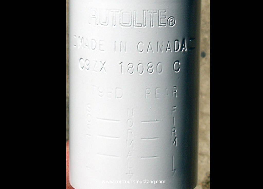

An original late white shock markings

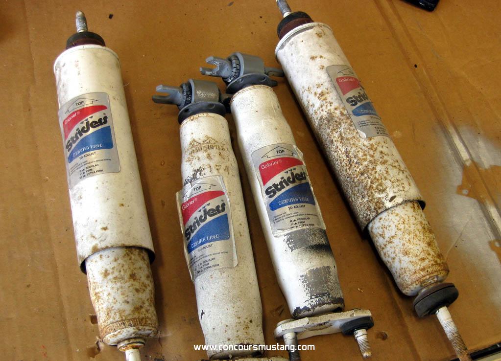

Later version of Striders that are unlike the original upper tub design
