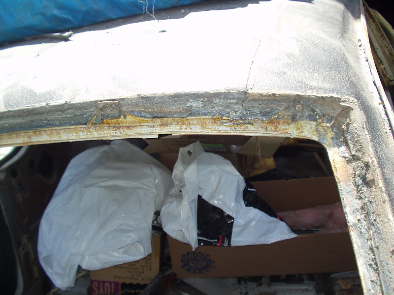

Here is a picture of the one that was on mine.
I know not a great picture but you can tell there was no seam at the A-Pillars.  I feel it was the original top becouse the nails were still there tacking the seams down.  Also the black silicon/rubber was in the drip rails.  Was it something that varied from plant to plant?
Have seen plenty of 67-68's without the A pillar seams - like your car. Have not seen many (if any) redone tops where the installer reused the tacks at the bottom of the pillar. Think you might have an original IMHO from what I can see

Agree with Jeff, if the tacks are there and the pillar sealant is still in place, most likely the original top.  The seam may have been predominant with 65-66 cars.
