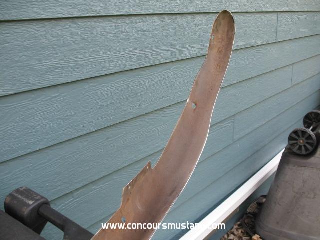

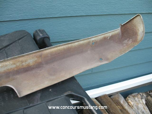

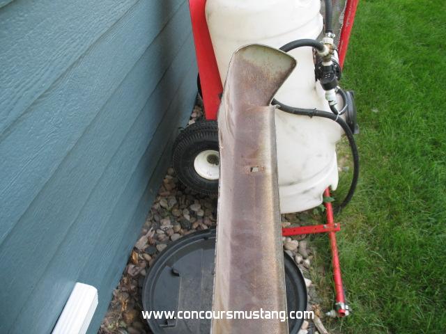

I believe I have two original bumpers but am not completely sure.  Here are the numbers I found on each of them.
Rear-M9 69, 65 1 from an earlier post I believe it translates to Monroe Sept 1969, June 5 first shift.
Front-69 M9, 11 11 3  Monroe September 1969, November 11 third shift.
The bumpers show no pitting but do need some minor straightening in a few places.   I'm wondering if it is feasible to have these replated.  Should I attempt to straighten the imperfections my self or leave that to the plater.  I live in North Dakota so I will need to ship them out for plating.

I have good luck with Sioux Plating in Sioux City South Dakota. I would let them do the striating. I think the last I had done it was $240-$250 each.

The reproductions do not have the part number on them. That price was based on a useable core. I all ways ask for the to do mine so I retain the correct date codes. They have a outlet in Lincoln NE. so I drop them off there. It is very covenant. I used them for our 68 HCS. Marty

I had really good luck with a place called North Star plating in MN.  They redid my original front bumper that a few minor dings--looks perfect and the date codes are still intact.
