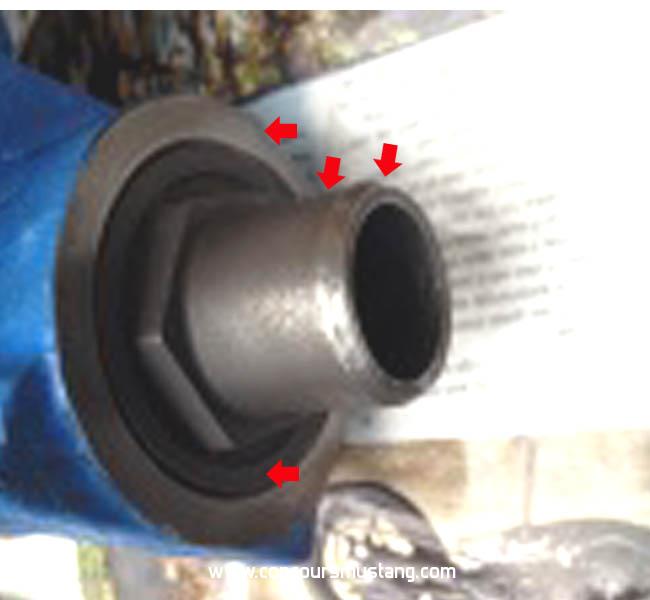

Hi again and thanks for the info so far. Just wondering how this part should be finished. It seems that the thread should be bright like a machined finish then the centre is cast but I'm not sure about the top cylindrical bit is it cast or machined and if it is cast the very top bevel seems to have been machined?
Dan.

  • Posts: 24864
Re: "Black out" on steering box for 1964 1/2 Mustang
« Reply #20 on: July 12, 2015, 09:22:49 PM »
On the top one with wire brush the threaded area (looks like it already has been and oil
On the bottom pictures I would
Red arrows - Brighten by passing a very fine sand paper over the surface. Could use it in a band form - might make it easier
And leave the other surfaces the cast color - Did look for any pictures of the ones I've done recently but hard to get the details in a picture. Either its too dark to show the differences our too bright and the reflections produce an odd look - or even hide the differences between the finishes
