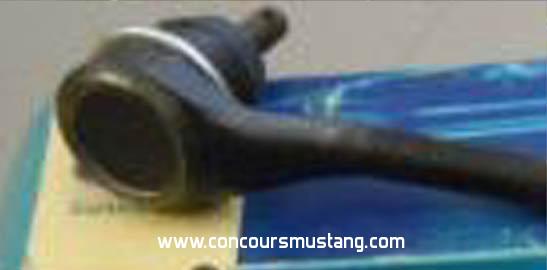

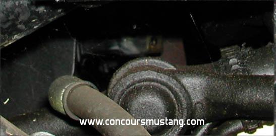

In the add - those are service replacements - compare the back side of the tie rods (machine steel) verses original which were stamp steel and shaped differently
From ad
From an original car
