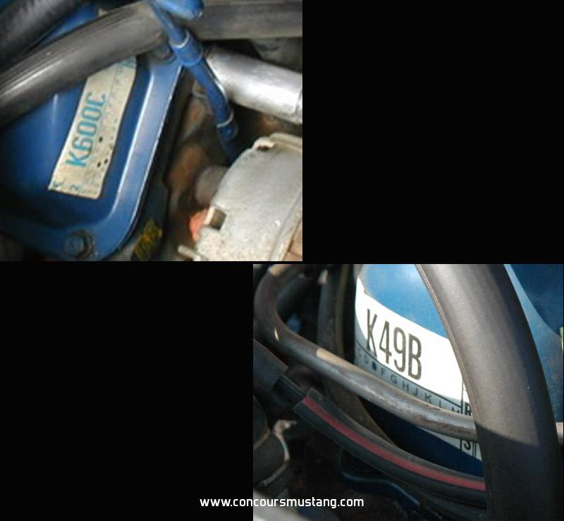

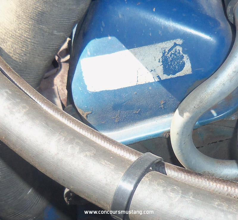

+1 . Thought the same thing. The sticker is more typically seen on driver side small block valve cover.
Re: Engine Paper ID Stickers -
« Reply #26 on: May 20, 2022, 01:05:07 AM »
Depends on year. Once you get into at least 73 then you have a different style ID sticker with multiple lines and punch out that are installed on the passenger valve cover as shown above. Just wanted to check to see if someone used a later year example to guide them with placing this one
In 71 at least some of the engine plants started to apply the stickers to the passenger side though the size, style and layout used in the earlier years continued
Picture below shows examples from 73. In some cases the printing changes to blue while black is used on others
