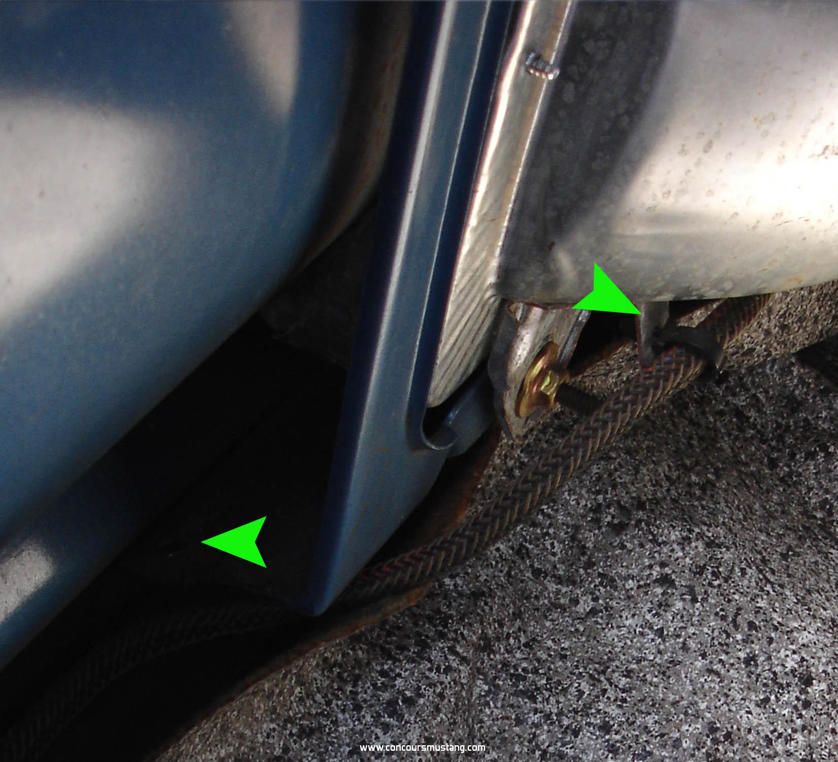

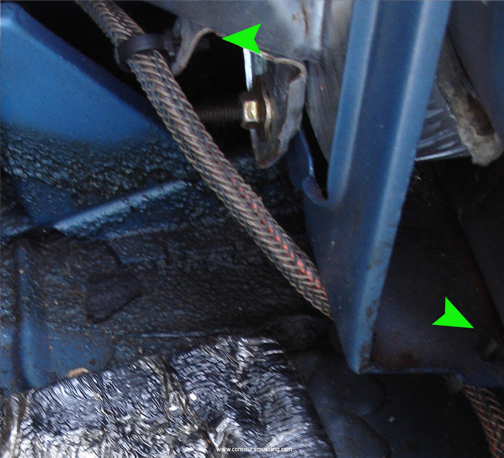

This should work for you photos of Brian's NJ car.     Note the plug goes through the side panel.
I would expect to see tape on the frame rail in photo 1 (SJ car?)
Wire then routes with clip (or clips seen on some cars -SJ Jim?) on the underside.

Awesome Brian,
 I guessed as much with the cable lengths and clips that attached to the tank holding screws, but wasn't 100%. I can see where it comes through so will be able to judge pretty close. I see from the underside the first plastic clip fixing as well so this is great.
On the harness that feeds the rear lights, side markers and number plate light do you have a shot of where the clips go to hold the harness? The car had some repairs done here but nothing major so I would have expected to find these also? I had a look at a friends 69 Convertible and his were attached to the tail light framing? :-\
Thanks for the photos Brian, it looks like an original car?

Thanks Guys, the photos are on the button. Should be able to find the holes and if necessary put them in, if they are missing. The car is a Dearborn so I'll check out the rear harness points as shown in the photos by Jeff.
Thanks a heap guys, and no doubt I will have some more. This ground up restoration is a big job so taking it slowly, peice by peice.
