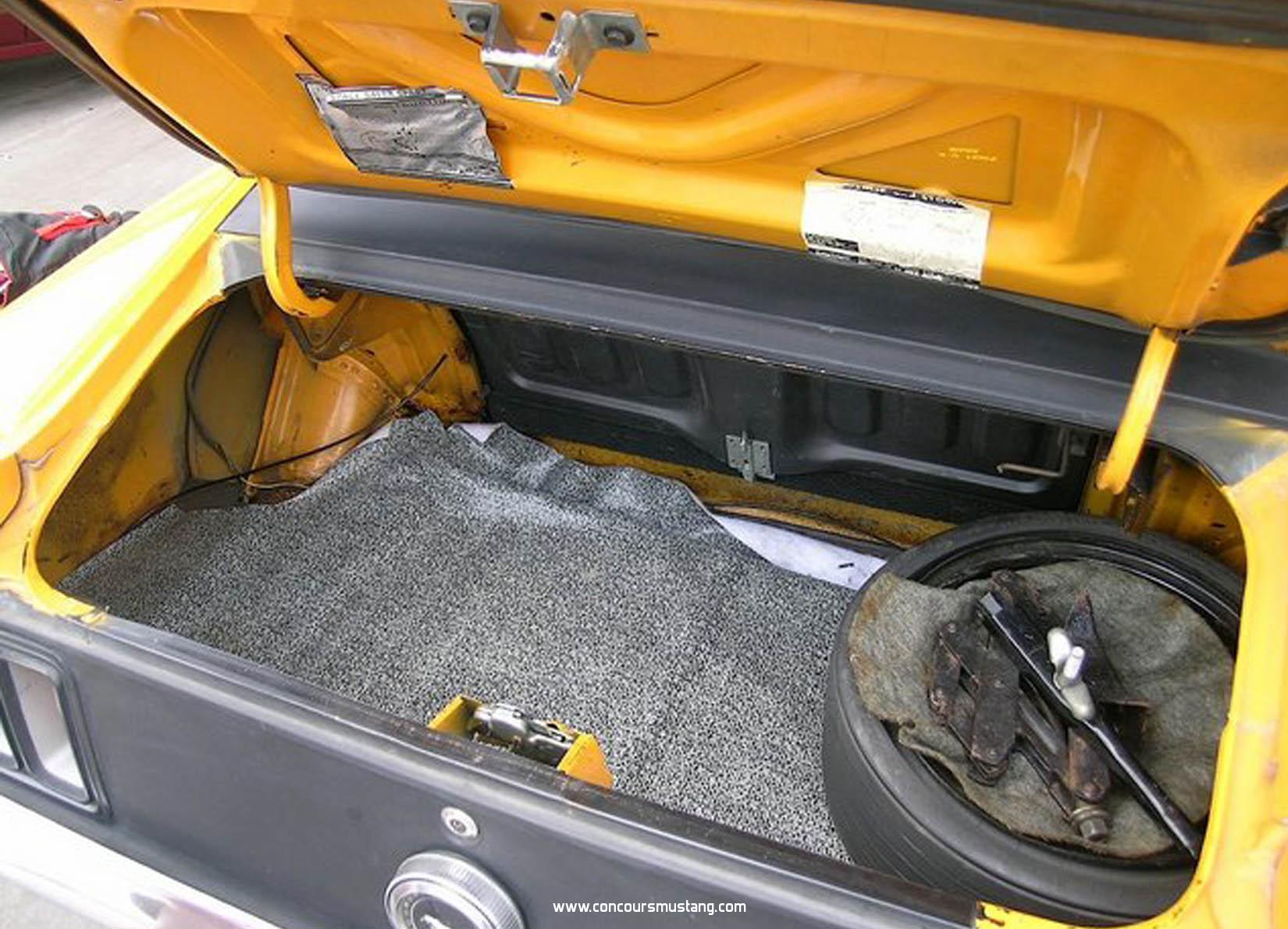

Here you go -
Note for others did find a different pattern on a very early car but that does not apply to this request ;)
0T02G1292xx - Looks like someone has been here with a black rattle can

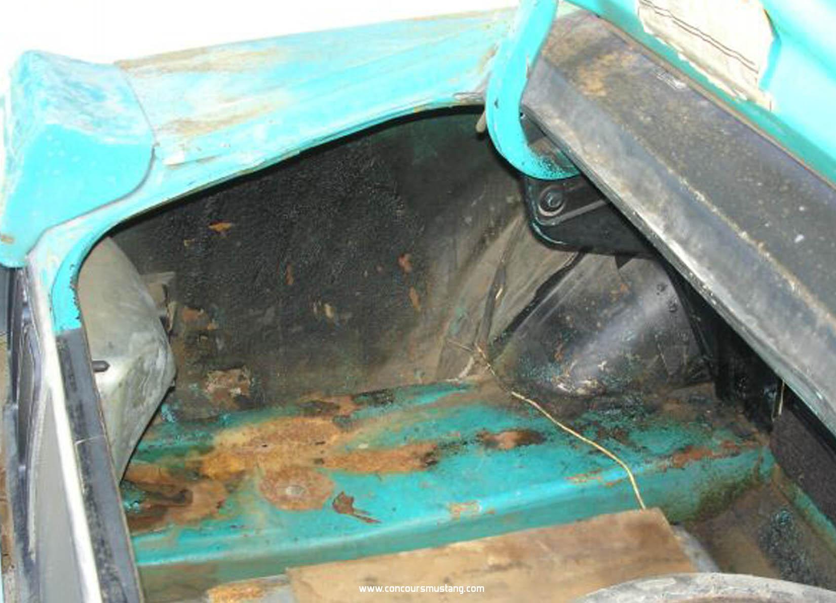

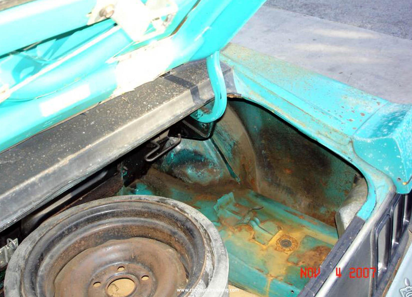

0T02G1285xx

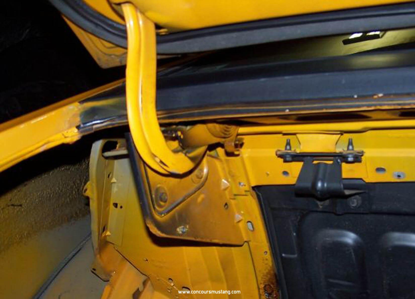

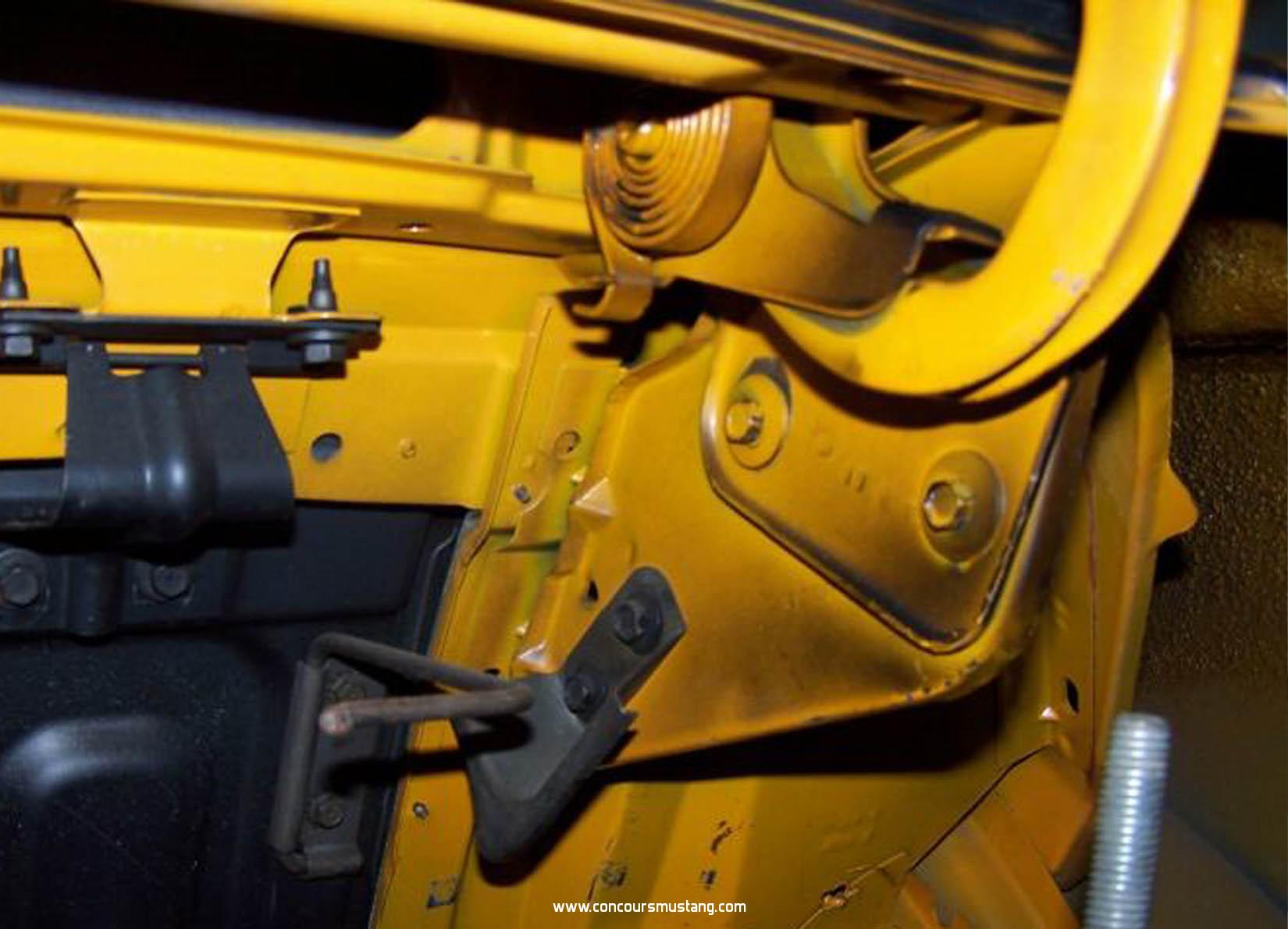

A couple to show some of the light overspray in the trunk area on this example

Thank you both for the reply and the pictures ,
