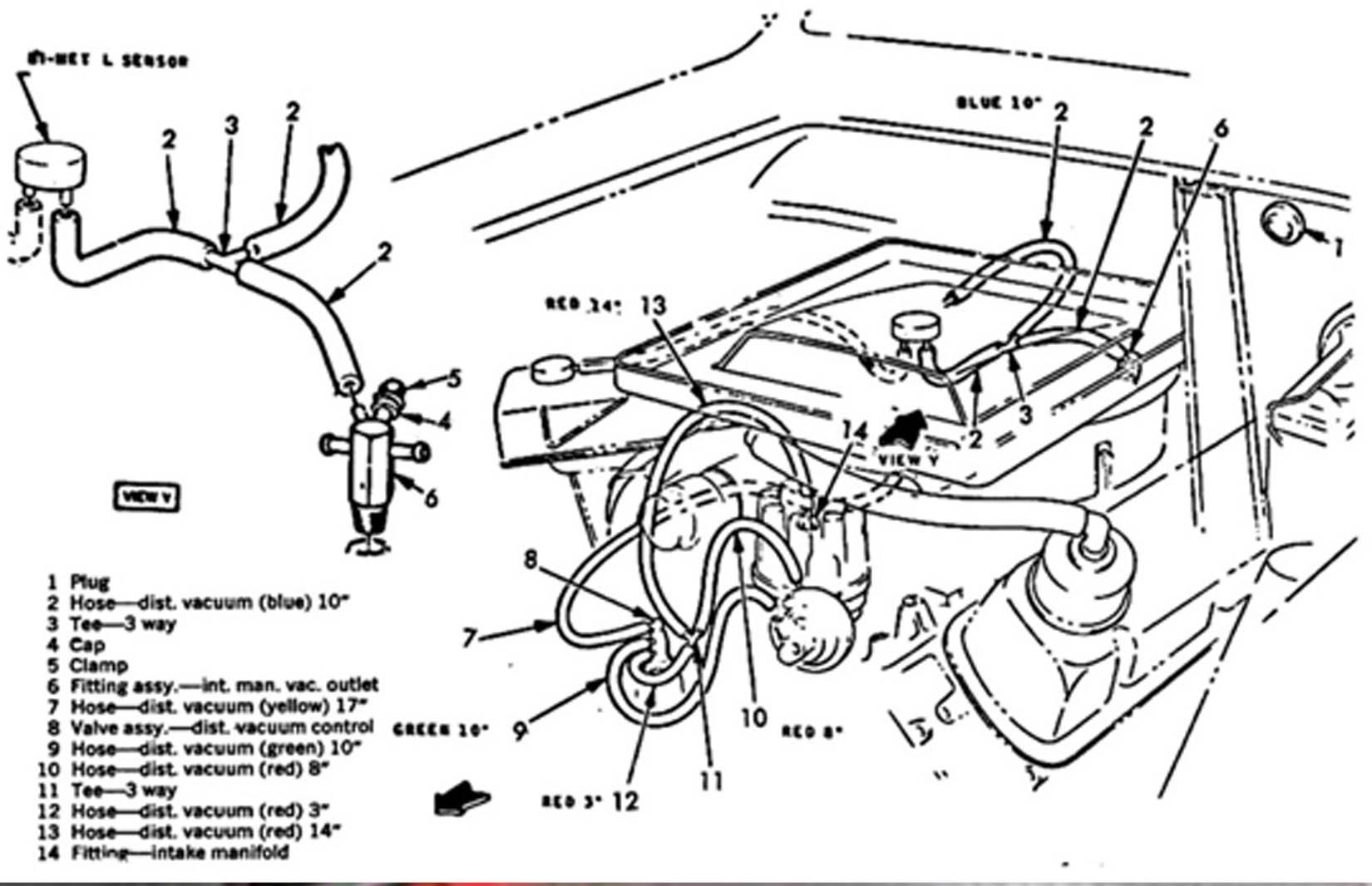

OK I'm in the posting mode today.Can anyone help me  with this?  where do i get a good picture or  a diagram for vacuuming schematics  for a 4 barrel Cleveland with a shaker and no air. this may seem like a stupid question .  :Mark

Guess I need to find time to do a routing article for the Library like we did for the 67-69's
Hope this helps - not the best but a scan of a diagram provided by Ford

 very nice and thank  You!!!!!!  Mark
