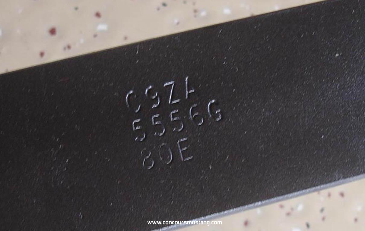

Here is another example - to illustrate the pattern
The letter (in your case) is currently believed to be the factory that made them (we don't have a decoder yet)  and the number is a Julian date
So 95 would be the 95th day of the year - 5th of April in a non-leap year
