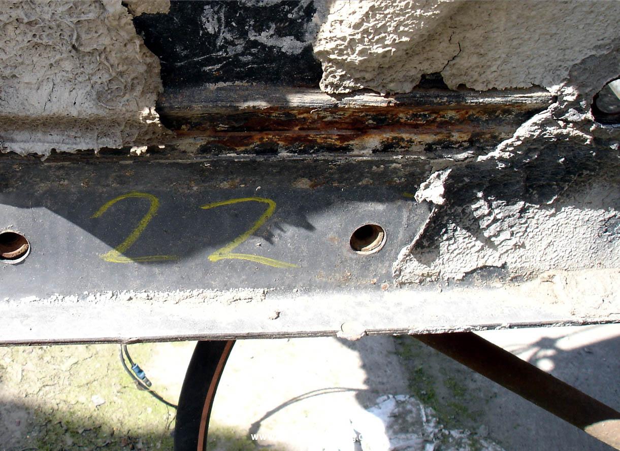

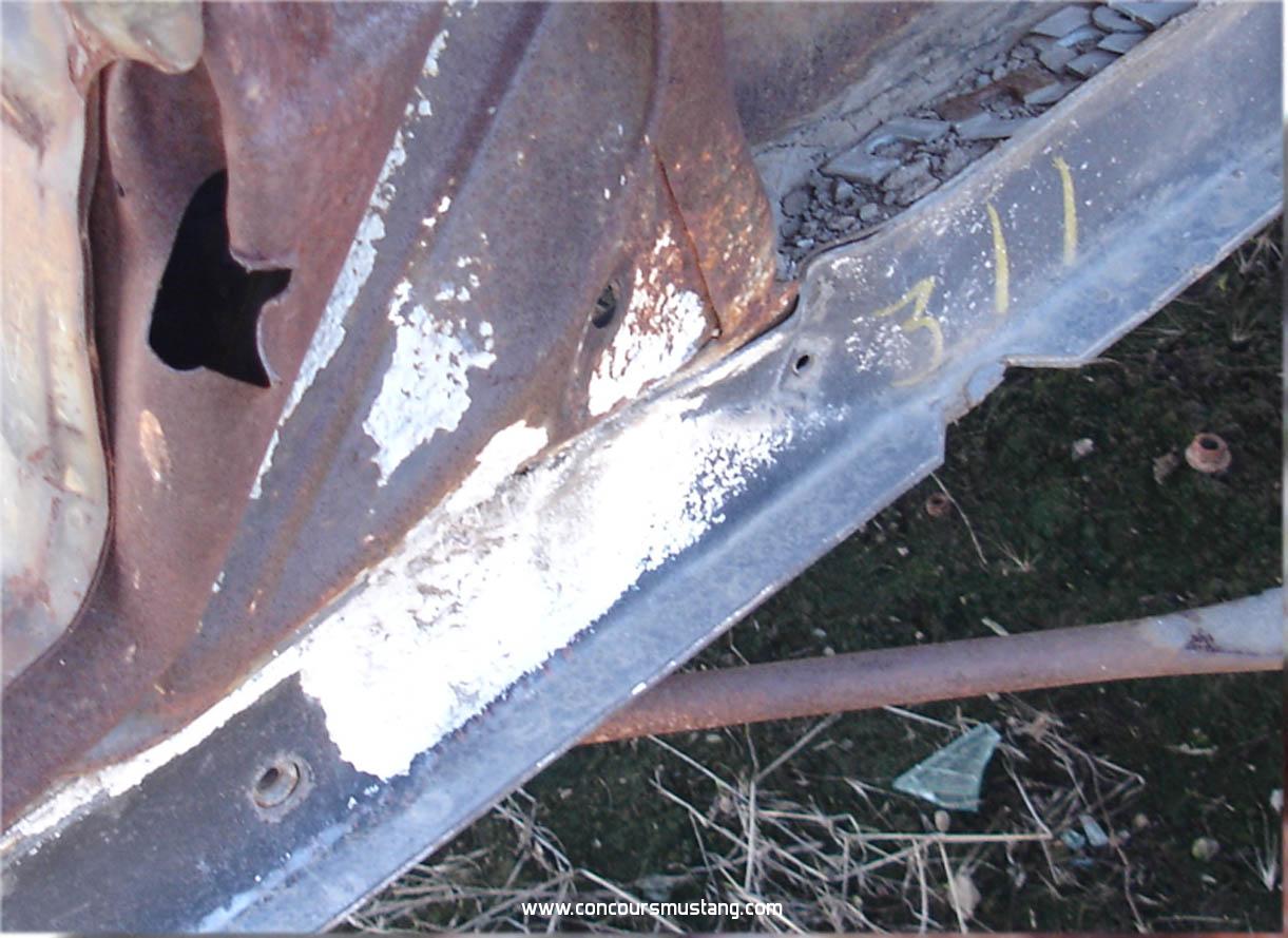

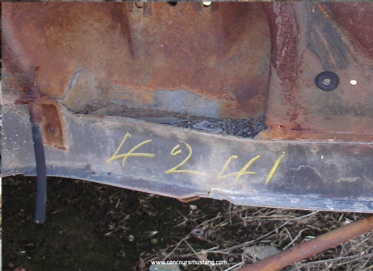

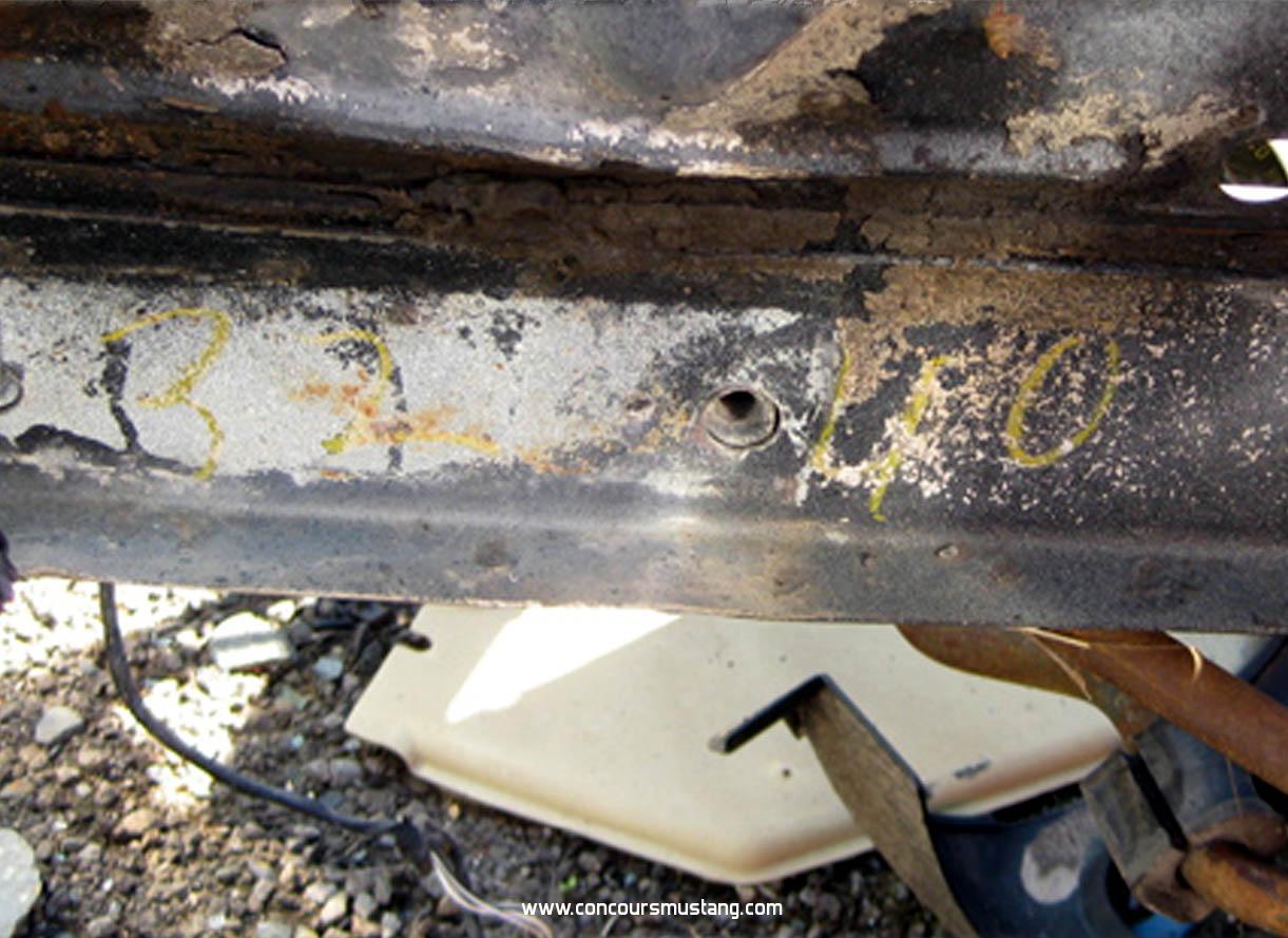

Here are some examples from Aug-Sept 65 San Jose. Looks like at least one worker earlier,  into Sept,  liked to apply the drivers side further forward so it would end up under the bumper bracket
5R07C13496x
5R08A13716x
5R09A1406x2
