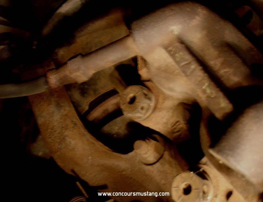

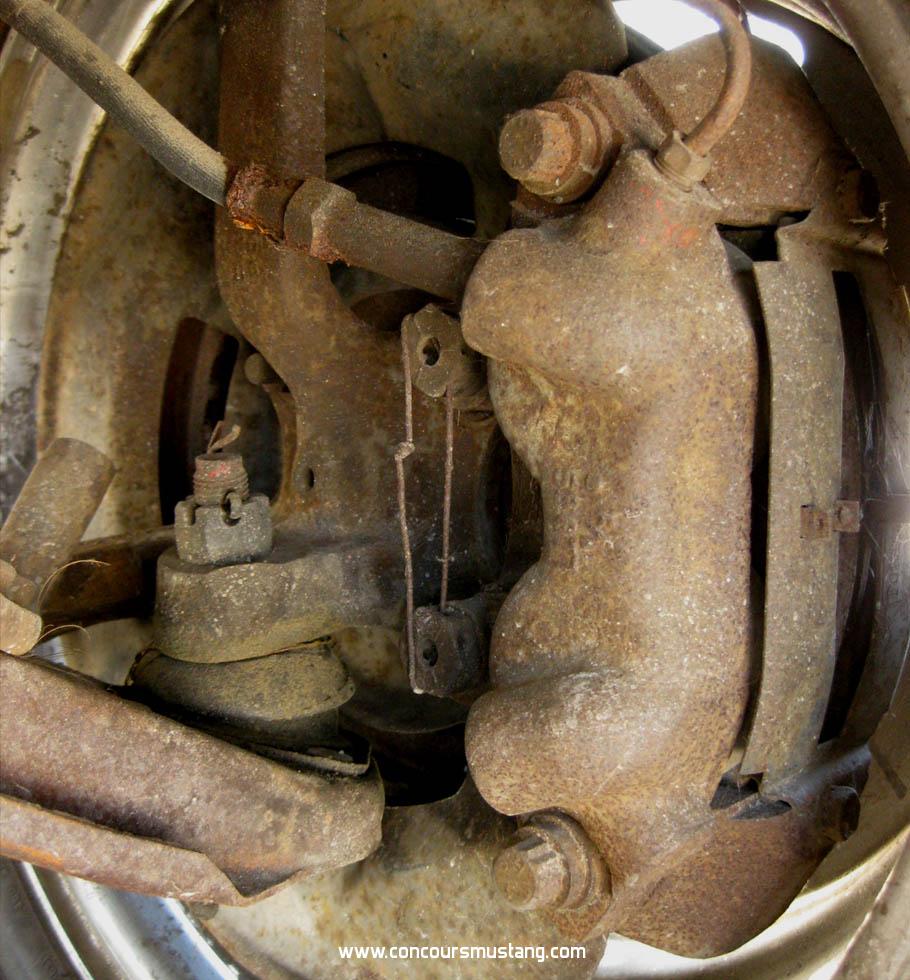

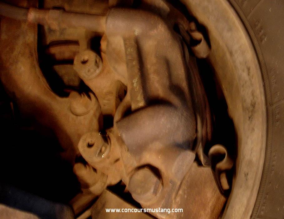

« Reply #5 on: March 16, 2015, 11:24:01 PM »
An original example from a December 15th scheduled car - Looks like a possible match
And just for comparison for others, one from a March scheduled example. Both San Jose

Thread size on the source line is 7/16 x 24 NS (national special).
Jeff, not to get off trail, but the first picture you provided has what I normally consider a 65-66 brake pad retainer (one large piece), whereas the last picture has what I consider the 67 style, two independent smaller retainers.  Do you concur, is that a slam dunk observation, or do I need to start a different thread?  I guess my post started with threads and ended the same.
Thanks, John

« Reply #9 on: March 18, 2015, 01:13:21 AM »
Jeff, not to get off trail,..................
We're still discussing Early San Jose calipers no problem following this path of discussion ;)
Believe you will find that the details you see in that picture is the way early 67 San Jose Disc brake cars were equipped and that the retainer changed with the change to the "stronger" reinforced caliper later in the year.  Looks like the original safety wire is still in place a rare occurrence IMHO
