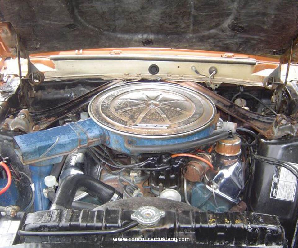

While we’re at it, in the photo showing the car with the incorrect brace placement you can see the air cleaner using the “FRONT” decal.  Never having seen an original 1969 surviving air cleaner housing with such a decal I’ve questioned if this is correct or just a ‘fantasy’ application.  If such a decal was used in 1969 was it specific to any of the assembly plants?  (I’ll respect he moderator’s call to start a new thread for this question if necessary.)

IMHO the only reason your seeing a FRONT decal is that its included in some decal kits and owners figure that they need to use all of them - as well as the CAUTION FAN :(
Did check pictures from all three plants and the findings support Scott's reply.   You can never tell what differences you'll find between plants and time periods :)
